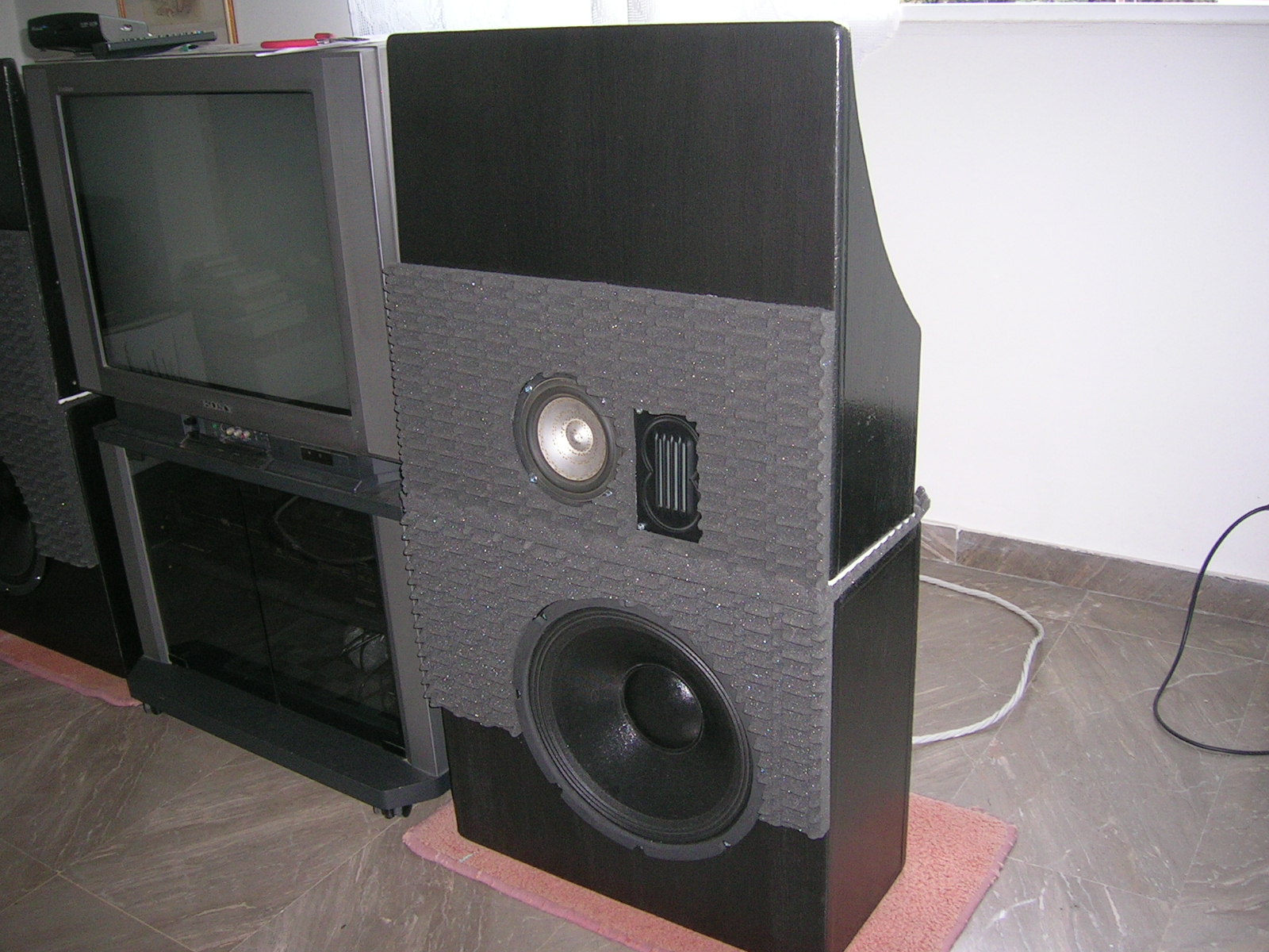

On test were a U frame 15”woofer and an OB 4”wide bander with an active two-way crossover 140Hz LP LR48dB/oct and 140Hz HP LR48dB/oct
Two measurements for each way: Acoustic response captured through mic 1m away, in line with the resp driver (the jarred lines), and electric response captured through output of cross over (the smooth lines).
What those plot showed was the effect that impulse response windowing has on gain and phase diagrams (yes, it is confusing)

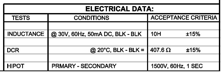

Would one of you happen to know the ballpark value for the self-resonance of this Hammond 10H common mode choke?
157H Hammond Manufacturing | Mouser
From Hammond data sheet.
Nothing about resonance.
There is one other choke from Hammond in the listings on the Mouser site which has an entry in the self resonant frequency column, and which reinforces the notion that the data entry person just pulled the number out of the air. It's for a 320mH part, and yet the SRF is still 60Hz. Ludicrous.From Hammond data sheet.
So the 10H number is almost certainly bogus as well.
I mean the 60Hz SRF is likely bogus---I have no reason to doubt the 10H. But for a 320mH and a 10H to have the same very low SRF is unlikely, so I think Mouser just made a couple of errors.It appears to be a 10H choke to me. Just measure it.
