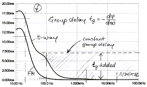

In well designed speaker systems, a Major problem is GD at low end... low freq. only ----->
View attachment 487114 EQ of GD
Another way is to extend the FR of speakers to very low Freq and then GD will be lowered down to lowest music freq.

Richard, the hand-writing on the 2nd graph you posed looks like Siggi Linkwitz, is that so?

Yes. Real delay is just straight up time from here to there. Offset drivers is a good example. Then there is the delay created by phase change. And, finally we have the mystery delay -- 'group delay'. Its the group delay which i have been talking about.... and it is mostly a low freq issue in well designed systems.
GD has a large affect on the quality of the low frequency sound. One way is to extend the freq response lower than the music alone requires. It is also why the HP filter to remove the low freq. junk fom TT/LP is so hard to get right.
THx-RNMarsh
Jan
yes.
One of many such graphs by many people for a long time.
We should pay more attention to reducing it every where we can for best sound quality.... both in recording and reproduction.

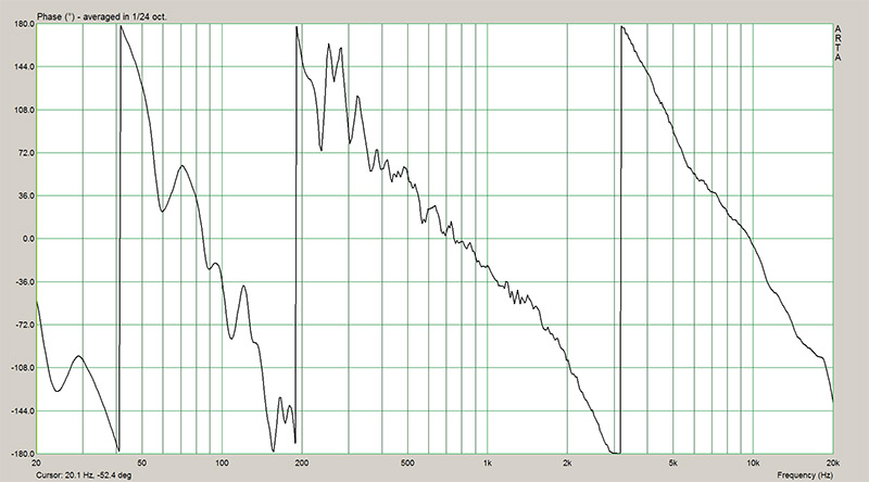

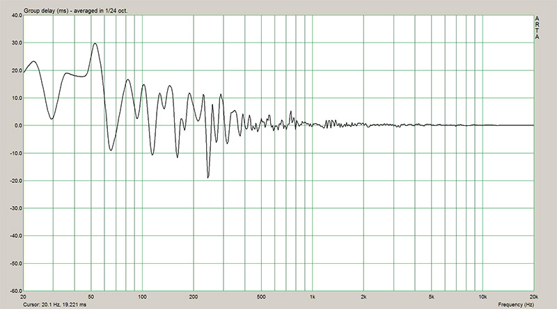

It is unfortunate that SL is in on the conspiracy as well, but let me try to explain again why in my view group delay is an irrelevant measure for audio. These pictures might show more than 2000 words can tell. They are both from a reverberant measurement, just to exacerbate the point a bit for clarity.
The first graph is unwrapped frequency.
The second is the group delay from the same measurement.
Two observations:
1) Group delay can become negative. Look at what happens between 50-something and 65 Hz. The sort of peaks and dips in the FR translate into swings in the phase plot, to the extent that within 15 Hz, the difference in group delay climbs to 40 ms.
Does this imply that the arrival of sound in these frequencies flip-flop 40 ms? No, of course not. Group delay is just a measure of the slope of the phase diagram. When phase advances, group delay becomes negative, and when phase slows, it becomes negative. That is all it measures, and 'ms' is a very misleading quantity to measure it in. It denotes nothing real.
There are HUGE dips and peaks in bass, even in well balanced listening rooms. All these translate in wild swings in the measurement of 'group delay'. It means very little if anything, psycho-acoustically.
To calculate arrival delay above the distance constant, you take phase/frequency. Nothing to do with 'group delay'.
2) Mother nature is logarithmic when it comes to things per second, so it seems. The plots above are made on a logarithmic scale for frequency. This coincides with the way our hearing works, as well as filter orders.
The first 40 Hz are very much not the same as the 40 Hz between 19784 Hz and 19824 Hz (and the first Hz is where all the gremlins are). However, the measure of group delay treats both 40 Hz intervals as the same.
With a relatively gradual rotation of phase as seen in the first plot, the group delay measure gets heavily skewed towards the bottom end, without representing any relevant phenomenon in the real world..
Have fun with the math.
Exactly. The meaning of negative GD values offends causality for most of the common misdescriptions and misuses of it in audio....Group delay can become negative. Look at what happens between 50-something and 65 Hz. The sort of peaks and dips in the FR translate into swings in the phase plot, to the extent that within 15 Hz, the difference in group delay climbs to 40 ms.

Gradual rotation in first plot? >1000 degrees; what this plot shows is that energy peak is occurring about 200 microseconds after center of measurement window.
The group delay plot shows that measurement window is long enough to capture modal behavior in room (from looks a typical domestic listening space).
Yes, do the math and work the units. Time v frequency.
Group delay is real, and well studied for a long time.

I agree with you and have dealt with GD for decades..... I cant bring myself to go point for point to argue because there is much wrong about the conditions, interpretation and conclusion(s). It isnt what research has shown and my own experience of its affect on timbre.
I need to say one thing about the conditions..... a highly reverb room is Not the best listening conditions and makes GD harder to detect. Also, dont leave out headphone listening which is very popular now with headphones which are light-years ahead of what used to be available.
So, if there is some poo-poo of it then that is an individual matter. The rest can try to do better and find the conditions right for it... even if it has to be done in DSP.

The phase shift is exactly as theory would predict to happen with a 3 way loudspeaker of the BR variety. Three 4th order filters (the enclosure and the 2 xover points) deliver 3*360 degrees of phase shift.
You are right that the measurement window is long enough to pick up room modes and other reflections; I mentioned that I was showing a reverbarent plot to make things clearer.
