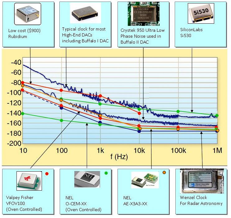

Richard, you have shown a bunch of phase noise graphs but I'm pretty sure
these are not the same fundamental frequency oscillators. A fair comparison
the fundamental freq must be same.
As freq goes up, phase noise gets worse. You can't compare a 5 to 10MHz
OCXO to say a 45MHz one.
There are some slight exceptions to this rule and the Crystek 957 is such
where the 45/49MHz XO's are slightly better than the 22/24MHz ones.
Terry

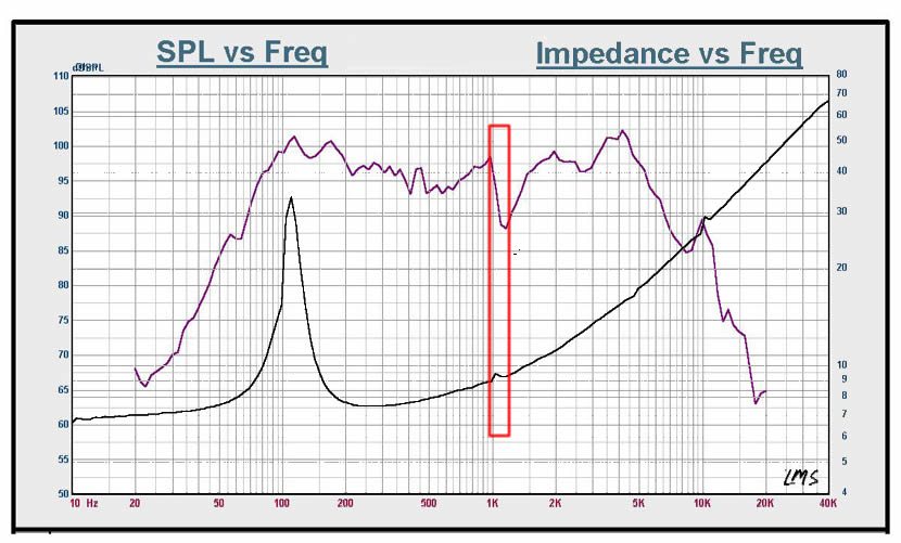

When it comes about to know where to find, on a given speaker response and impedance curves, the frequency where the membran will begin to fractionate, it is (most of the time ;-) quite easy, even on catalog.
