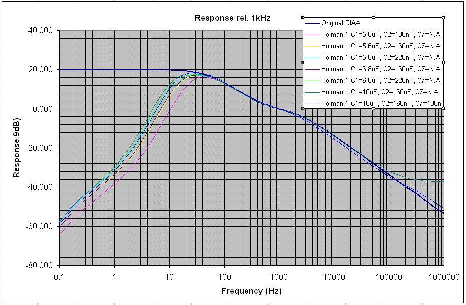

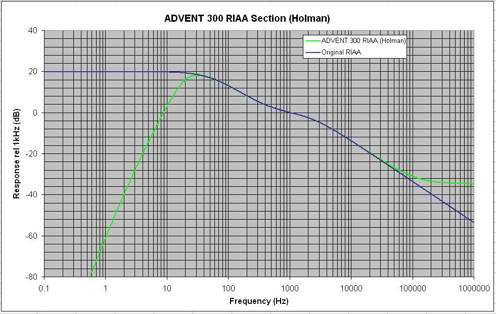

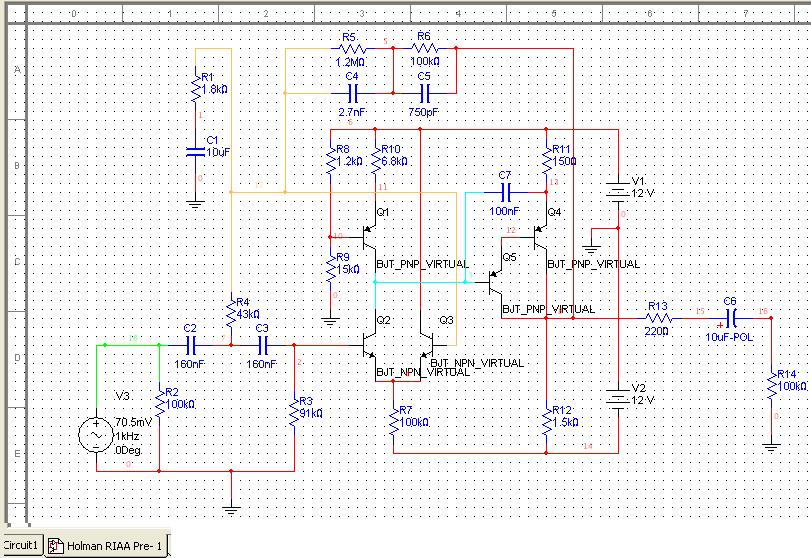

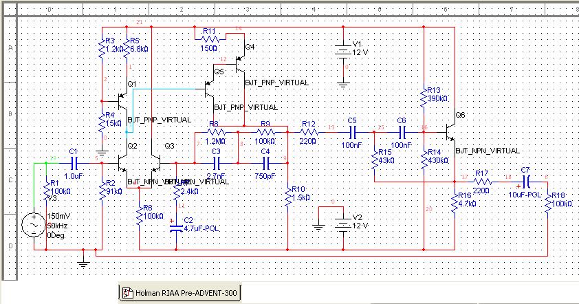

I wish Tom had included some values on his schematic. I'm somewhat dubious about the two-pole filter components right at the input.
Your details and comments:
Phonograph preamplifier network with infrasonic cutoff response

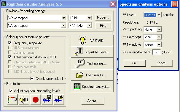

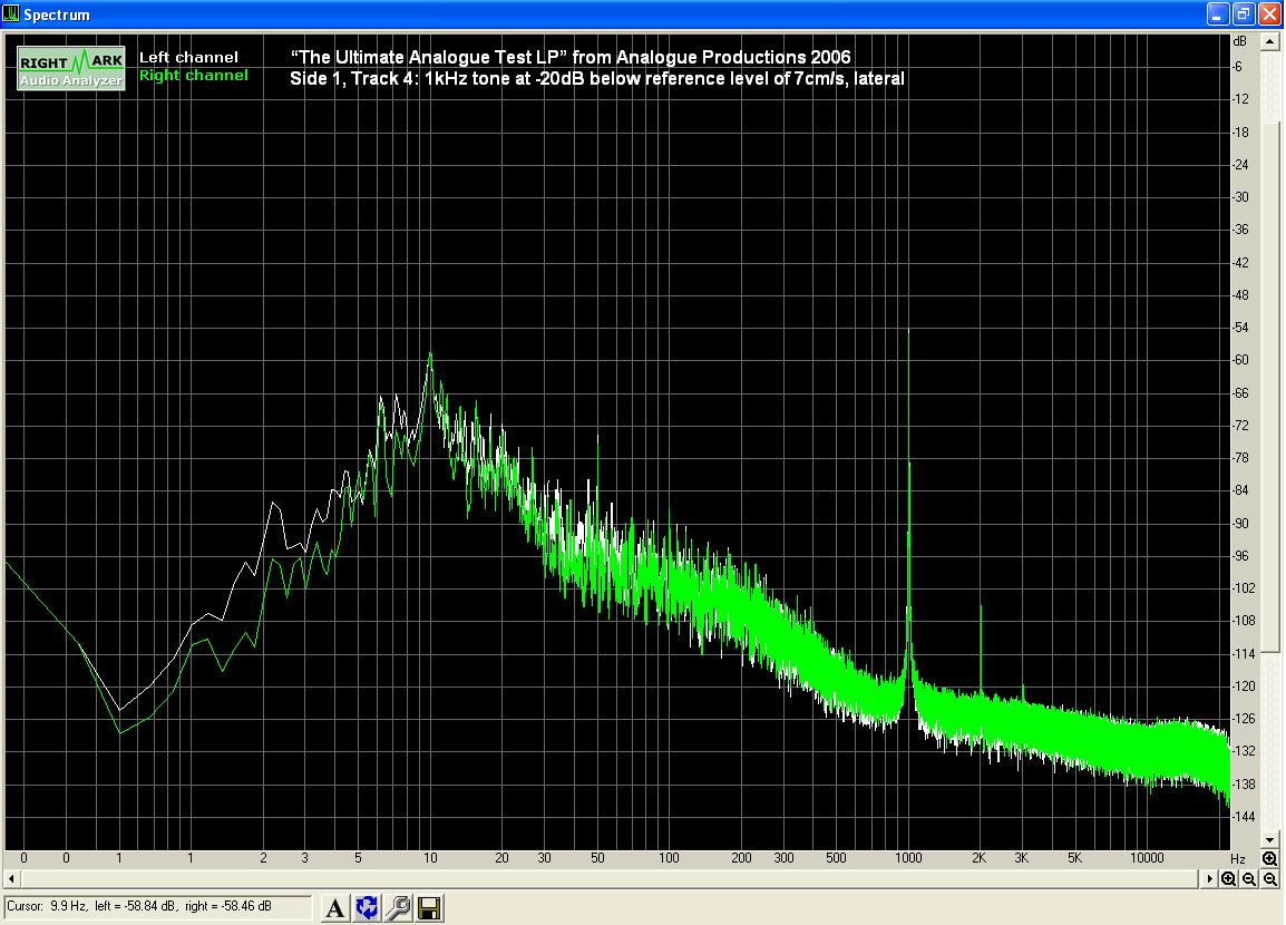

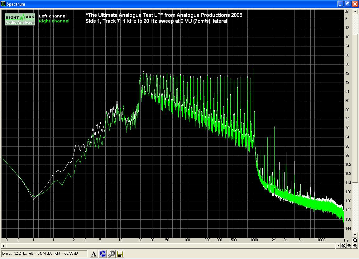

I would love to see an FFT from a digital capture from some 10 seconds of your cartridge reading a blank groove.
If you have a soundcard, record the RIAA output as a 44.1/16 wav file and use the free RMAA 5.5 for doing the FFT (262144 samples) on it. Then, post the screenshot
RightMark Audio Analyzer - Software Informer. RightMark Audio Analyzer tests audio parameters objectively.

It will be a month before I do my serious 1/f deep digging test and measurements.Right now my spare time is consumed trying to finish my article on this, but the possibility is certainly there.

As for recording, I'm willing to do it, but it will be sometime in July when my domestic situation allows me to FINALLY settle in my room, with all of my audio devices. Until then, my TT is out of commission.

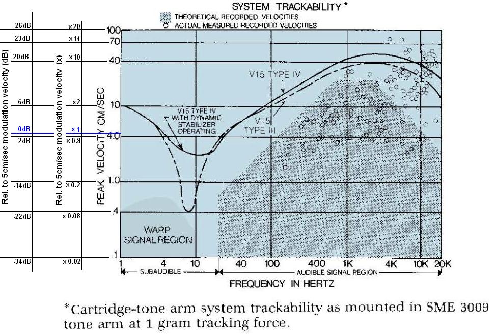

BradWhat do we suppose such an overload margin should be?
To make it easy, see the familiar attachment.
The solid line of V15 Type IV is a good guide for what we should expect at the subsonic frequencies too.
My observations make me say that at ~10Hz the signal coming out from the cartridge is an equivalent to a modulation of 1.5 to 3 cm/s.
Again, this is the result of signal amplification by ~12db due to arm/cartridge resonance.
The 6dB variation (maybe a conservative number) is mostly due to resonance amplitude and Q variation among different systems.
The actual vinyl content at ~10Hz is an equivalent of a 0.2-0.4 cm/s miniscule modulation velocity.

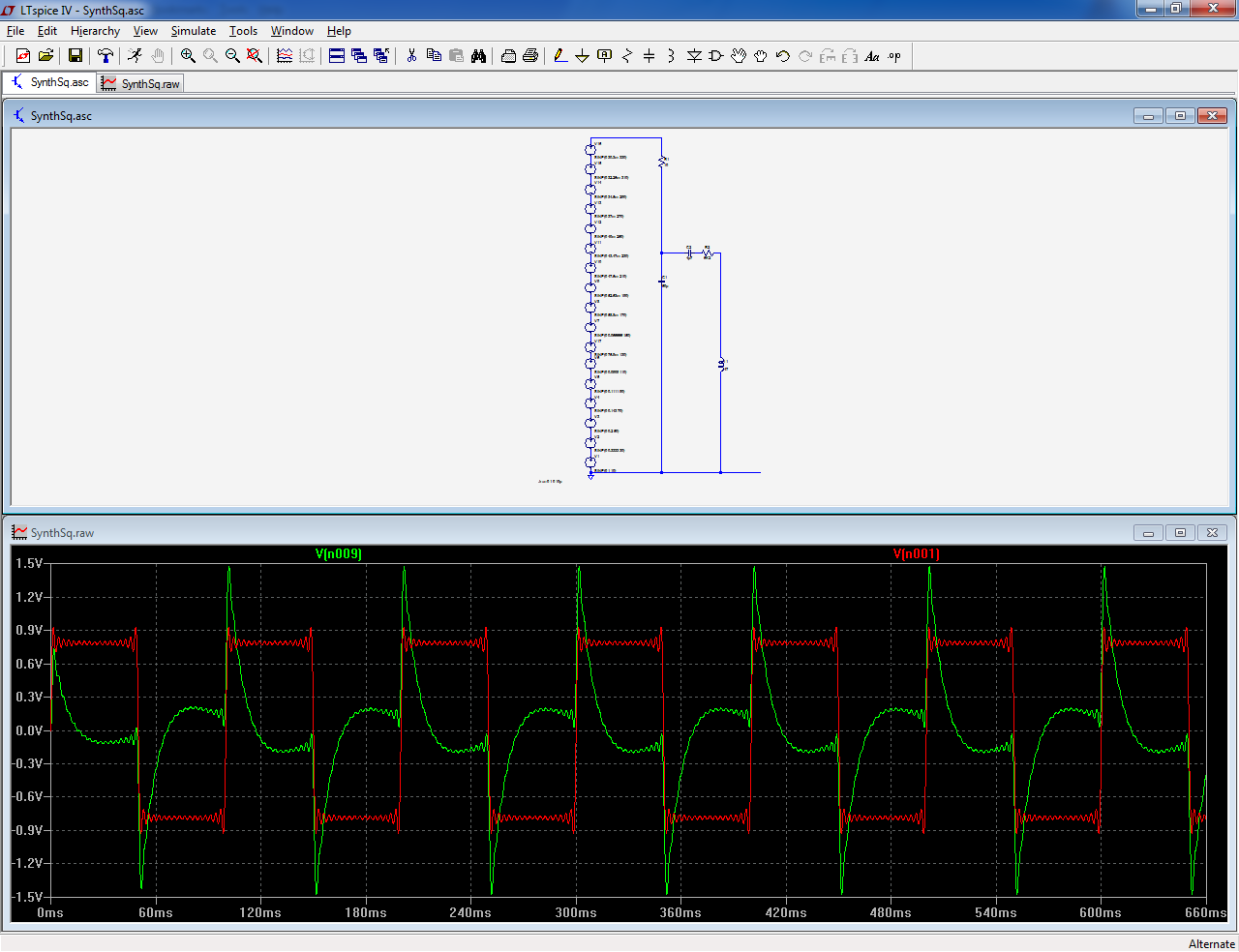

Why ? Transients are harmonics of th fundamental.However, the bass transient response will suffer, even with an added 10Hz filter.
Phase shift.
About 37 years ago, while working with HK as a design consultant, I tried adding the extra roll-off to an analog simulation of the tone arm resonance. Then with a step function or low frequency square wave as a drive signal, I looked at the results on an oscilloscope. Adding the extra 6 dB/oct. rolloff always made more phase shift, and so degenerated the transient response, no matter how flat it made the overall bass response.
Today, a SPICE simulation would show the same thing.

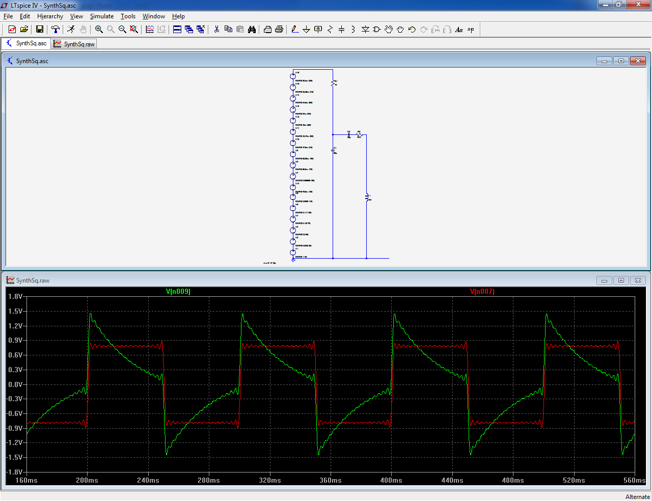

Graphically, the answer is pretty obvious:Why ? Transients are harmonics of th fundamental.
this how a synthesized, band limited (for phase accuracy) 10Hz square wave looks like before and after a 10Hz 2nd order HPF filter (Q=0.5).
Ok, a bit extreme: let's make the filter's frequency 3.33Hz. Not so striking, but still compelling.
