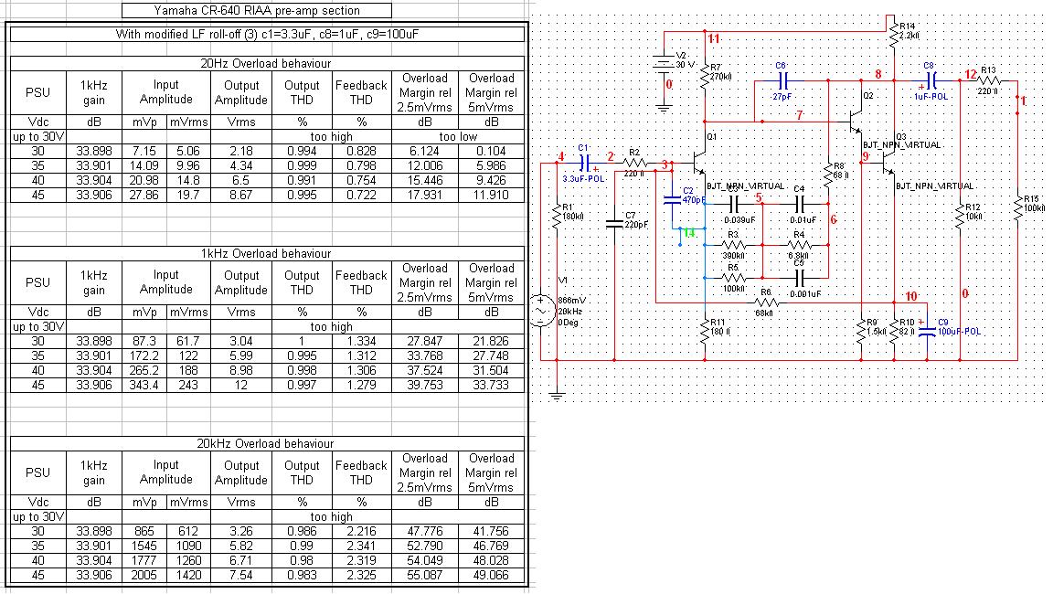

I have measured various RIAA preamps. At 10Hz, response varies from +2dB to –20dB rel RIAA curve.
I mention the 10Hz as to comply to your second question.
The strongest subsonic electrical signal at the cartridge output is at the frequency of arm/cartridge resonance, usually around 10Hz.
How strong this signal is, depends on:
1. The amplitude of excitation signal, i.e. vinyl record condition
2. The degree of arm/cart resonance dumping. The resonance can achieve an 12-20dB signal amplification at the region of resonance peak
For a vinyl record in good condition, a 1mV per 1cm/s MM cartridge and a moderately dumped arm/cart installation, expect 3mVrms from the cart at around 10Hz . (I can provide data for these numbers if you are interested but the post will be lengthy).
For your second question.
A case as described in the previous paragraph and a RIAA preamp (33dB/1kHz) with a moderate LF roll-off achieving -8dB at 10Hz, as in the attachment (it has three caps affecting the LF roll-off, C1, C8, C9)
10Hz voltage across the input coupling electrolytic cap (C1): <3mVpp
10Hz across the shunt electrolytic cap at the feedback circuit (C9): 110mVpp
10Hz across the output coupling electrolytic cap (C8): 2.5Vpp
When the RIAA preamp embodies steeper LF roll off, the AC will increase across some caps and decrease across some others, depending on the circuit and the LF filter implementation.
In any case, I don’t think that this range of AC signals across the caps will cause distortion.
I find far more important to reduce the likelihood of overloading.
Many RIAA preamps have very small (or nonexistent) overload margins at subsonic frequencies

I have modified an MAudio 0204 USB for DC coupling (non-audio use) and I was trying it to capture phono. I got about 20 min before somehow it froze my machine (Win 7). I will continue my experiments when I sort it out,
If the problem does not appear when you reduce the recording resolution (or happens at a longer recording length), most probably it’s the buffer size that your program is using.
but I think taking minimal gain up front and digital filters would be best. The trick of running IIR filters backwards and forwards (net linear phase) looks interesting
Keep us informed Scott, but I don't understand this backward-forward trick.
We have read that digital RIAA filter has to be implemented through IIR filter for to preserve the phase behaviour of the (complementary) analog filters used in the master's cutting process, no?

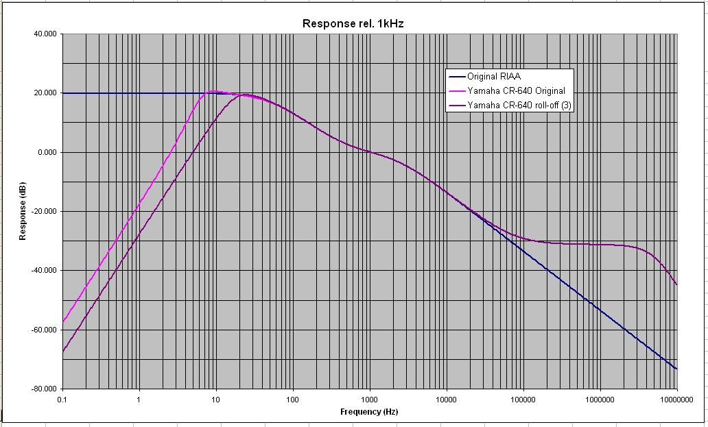

Guessing is not allowed as fact. Distortion across the cap could be significant - esp 2.5v p-p.
That’s correct Richard.
I don’t know how high distortion can be at 2.5Vpp across the cap. Maybe you can give a number.
But it is certain that with a steeper LF roll-off upstream, the AC voltage across this cap will reduce.
However, the 1972 IEC standard is to cut at 20Hz...... making the situation worse than your example.
1972 IEC is 4dB down at 10Hz
My example is 8dB down at 10Hz (a steeper roll-off )
Overloading at low freqs is easy to obtain with less than SOTA turn tables and phono stages using non-perfect records (warp, rumble, flutter, wow etc)......
From what I’ve seen so far, I can not expect anything less that 1.5Vrms at 10Hz from a 1mV per 1cm/s MM cartridge. So the successful step is to build a phono stage with an adequate OLM
And, I agree with JC..... if you have a clean enough TT/arm non-rolled off would sound better.
“Sound better” may be attributed to some other factors as well
The only way to say if subsonic cut filters cause phase issues an octave and beyond above at acoustic frequencies, is to compare two digital filters with same slope and turn-over frequency point but the one with linear phase response. Scott?
