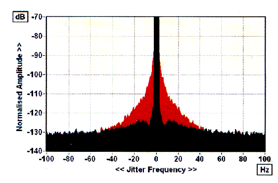

Even more on jitter...More on jitter, from what I have gleamed from posted notes and internet searches the audibility from listen tests does seem to be around 10ns (in some very rare cases less than that).
The Well-Tempered Computer
The contention is that very low rate clock centre frequency variance is relatively very high in amplitude (1/f noise characteristic) wrt audio band jitter, and is subjectively much more destructive."Low Rate Uncorrelated or Noise-Like Jitter" - to quote Paul Miller.
So there you are, we even have a "name" for it, albeit a cumbersome one.
This kind of jitter is very hard to measure. But it is also the kind of jitter that makes digital sound DIGITAL. Peculiarly, the other forms of jitter are far more likely to make sonic differences that are perceived as analogue differences. Hence we can hear the differences in digital cables etc., as Harley points out, things like digital cables takes on analogue behaviour.
But rarely are these difference DESTRUCTIVE in nature, more like "voicing" in speakers and we pick our preferences.
But we are targeting something beyond "voicing" - something OBVIOUS to the ear as WRONG, something we have collectively coined... DIGITITUS !!!
UNL Jitter, Uncorrelated Noise-Like Jitter.
The Terra Firma Concept: Jitter is Analogue
This is why I have in the past mentioned jitter spectrum.
White noise clock instability causes a, well, white noise noise cloud over the reproduced audio.
VLF clock instability causes a 'vibrato' effect, and this is distinctly audible causing general lack of image clarity and stability, in particular centre placement and depth imaging, and sense of wrong pitch.
