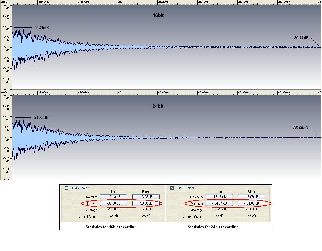

Thank you Pavel for the drum sound uploads.
I listened to them through headphones, after midnight.
My first impression was that the 16bit recording was a bit louder.
After many listening rounds I wasn’t sure anymore.
Then, I compared repeatedly the two recordings in detail (sections of 1-2 seconds). Couldn’t perceive any difference either with certainty or at all anywhere else but the hat hit at 27s (the decay sounds to me as more abrupt on the 16bit recording).
After the listening sessions, I checked in detail the signal level of the files second by second through a wave editor.
At digital silence: 16bit is –90.xx dB, 24bit is –133.xx dB
At very low passages <-60dB level: 24 bit is 2 to 5 dB lower in level.
At passages >-50dB level, there are no differences (only at the second decimal of a dB)

Thank you George, I might point out that if properly dithered there is no quantization noise simply a noise floor. I might add that if you A weight it the 93db goes to about 95dB at 16 bits.

In Audacity, amplified by 30dB it's easy to see why this is so: the 24b decay trail is still clear of the noise, but not so for the 16b. The ear "follows" the sound down as it fades, and with the 16b the noise accompaniment starts to intrude noticeably on the last audible segment of metallic ringing - the ear rapidly has to work harder to filter out the musical component at the very tail of that bit of sound, and subjectively it seems to "disappear".
