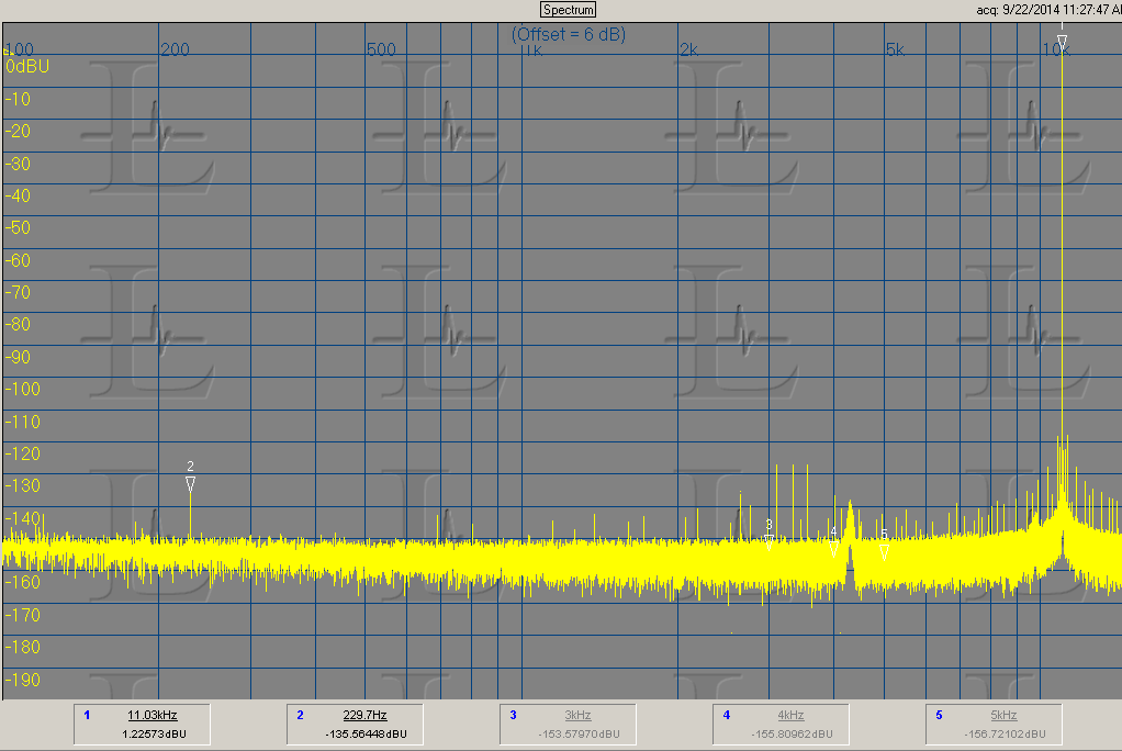

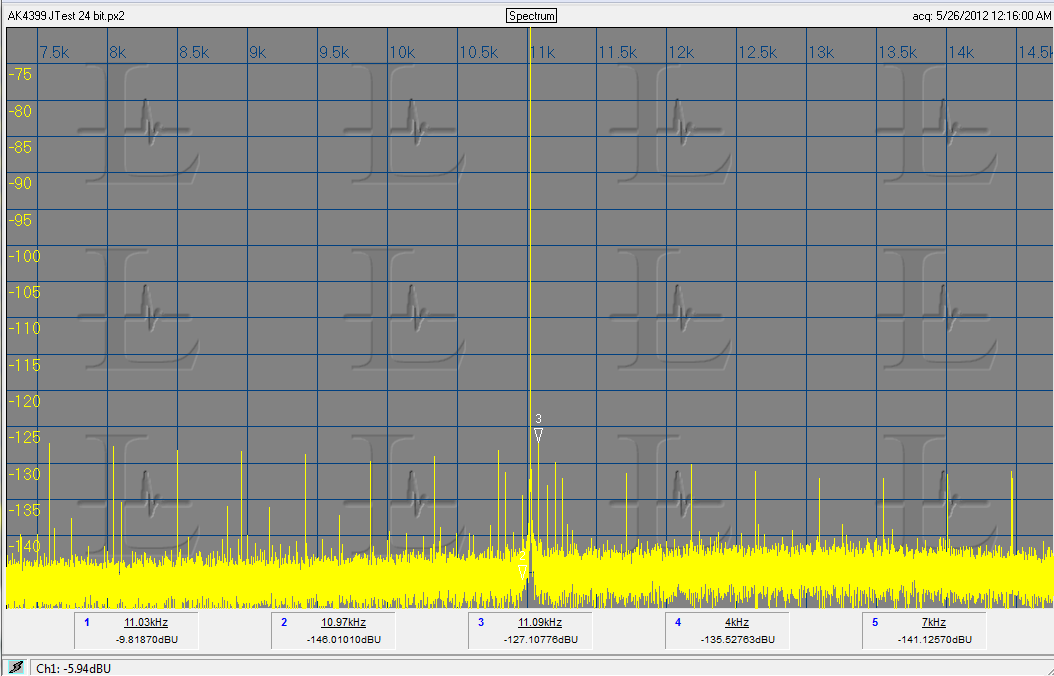

It looks like your testing the jitter tolerance of the SPDIF receiver. The current generation is really very good. The Jtest is a better tool for testing since it creates the most stress on the receivers jitter rejection. You do need to use Fs/4 or Fs/2 to see the jitter since lower frequencies are less sensitive to it. And a high resolution FFT since you are looking for close in sidebands.
Here are some examples. (JK generator to AK4490 demo board at 44.1 KHz 24 bit) All the jitter sidebands are close to the 12 KHz tone. The second image is formatted similar to the Stereophile format. (AK4399 demo board and the JK generator).
