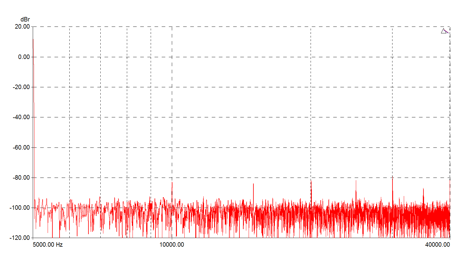

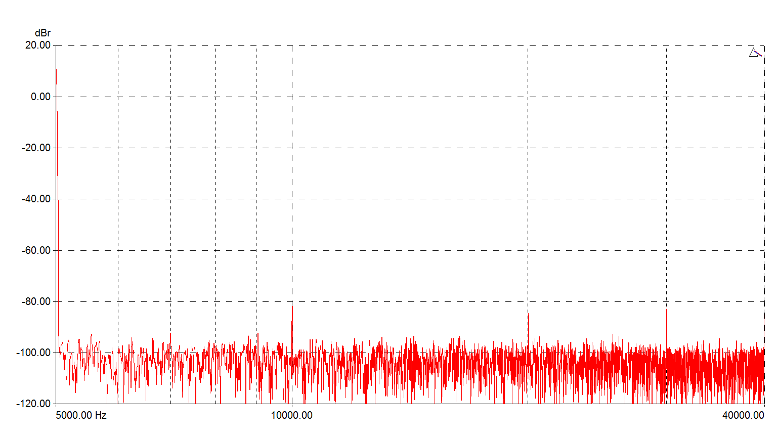

Some lighter fare if I may; played a bit with my vintage QUAD 405-2 this afternoon. You know that this current dumping amp is basically a bridge with 4 elements: 2 resistors, a cap and a coil. Bridge balance would (in theory!) cancel all distortion.
I replaced one of the Rs with a trimmer so that I could balance the bridge, and what do you know, I could cancel the odds to the point that they disappeared in the noise. Isn't that a nice experiment! JC you must love this amp no 5ths, no 7ths! :)

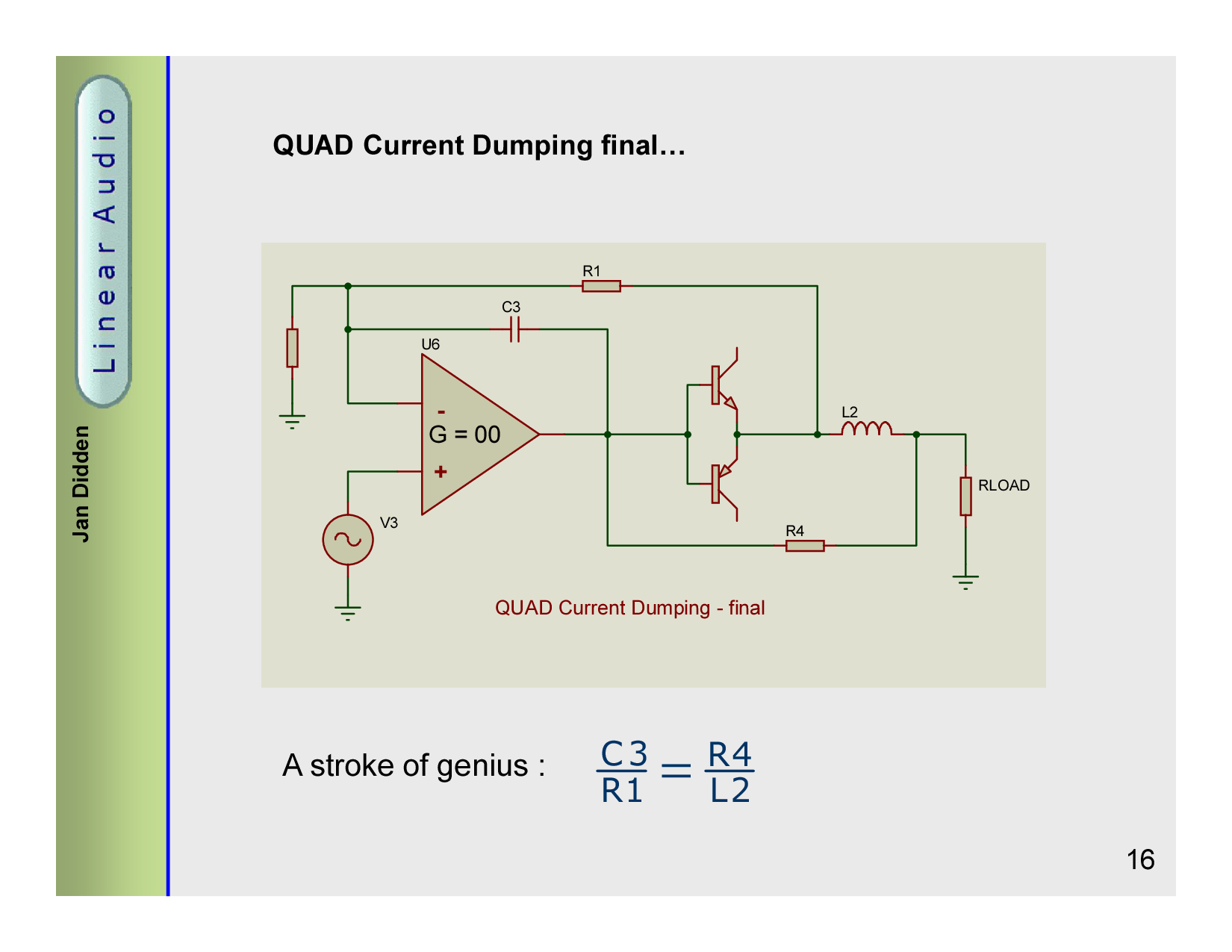

No the bridge values have no direct relation to the load. It's really inherent in the design of the current dumping concept; very smart. When the dumpers come in, it doesn't just change the loop gain but it also changes the feedback factor to compensate for the dumpers gain. That's where the bridge comes from: feedback from the class A main amp and the feedback from the dumpers chain form a bridge-like circuit and when precisely balanced it cancels all changes in loop gain and feedback factor.
Not something you can casually insert in a 'regular' amp.

In a regular amplifier you can use an input output comparator to generate an error correction signal. This can be applied through a gain reduction resistor via a separate cable to the loudspeaker terminals. Very tricky to properly balance it.
AX tech editor
Joined 2002
The problem with this and similar approaches is that it is pretty much impossible to maintain the balance over frequency. All kinds of parasitic inductances and capacitances will rear their collective ugly heads. If you read Giovanni Stochino's articles in Linear Audio you'll know that those issues are by far the most difficult - all else is child's play.
The beauty of the current dumping approach is that the bridge has a cap and an L, so with increasing frequency the cap impedance goes down but the L impedance goes up. The bridge is arranged such that the ratio of the two arms (one with the cap, the other with the L) remains constant. Peter Walker was a brilliant designer, the epitome of 'thinking out of the box'.
Edit: attachment from a presentation I once did gives the concept.
