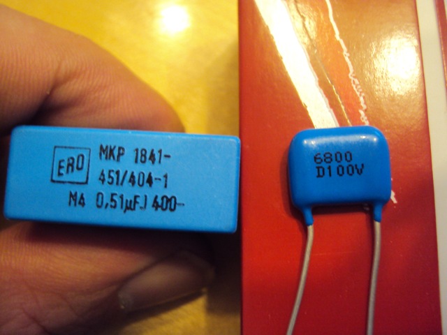

I think a KP is a film and foil Polypropylen but i actually think it was an MKP so that whould be a metalised Polypropylen. I think it was around 0.5uF. I look if i can find it then i send a picture. I am absolutely sure that material is not the only factor.
Here are the two caps. Before i had the MKP and then i used the Mica. The Mica showns 6.8nF but i use 10nF. Actually now i know one of my sins. I cheated because i compared the
Mica loaded with 220Kohm and the MKP with much less impedance to get the same crossover frequency but that whould put the Mica into a disadvantgae because high impedance brings out the DA even worse. One reason could be that my preamp likes the light loading of 220kOhm more then the lower impedance i need for the MKP.
Joachim, I am somewhat knowledgeable about DA and it does NOT go away with loading, at least not with an audio signal. However, you should try a different brand, maybe REL next time. Many audio designers have had great success with Rel RT polystyrene. Why? I cannot easily prove, BUT it is low Q in mechanical resonance, and well made. The DA difference between polypropylene and polystyrene is difficult to measure, but please try polystyrene from Rel before making a decision. There are others just as good, but I know Rel can do a good job.
