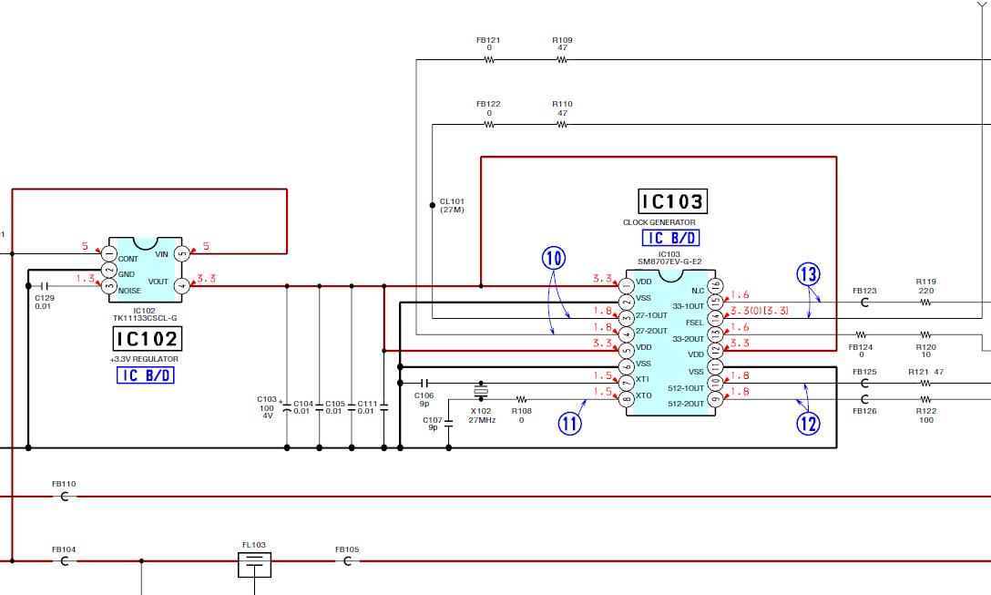

George, while you're at it - check how the clock is generated in this player ;)
Best,
Here it is (and as you know, implementation details matter) :)

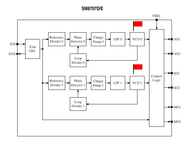

George, what implementation details? No PLL/VCO based oscillator will produce the same low jitter figures as quartz crystal based oscillator. One can't polish a turd, as they say ;)

OK. On paper not the best in the world, plus audio clocks with this IC have more jitter than the video clock (but the numbers are low).
As Richard’s Sony CD machine is a universal player (with a billion self, auto, manual adjust/test modes and diagnostics :) ) this clock-generator IC is connected to the following ICs:
DSP, AV Controller, DSD Decoder, Audio Digital Signal Processor, DAC, all spread across a large highly populated (on both sides) PCB.
Even if it is the best clock in the world in terms of specs, the actual clock jitter, noise ect measured at the input on each of the supplied ICs, will depend on tracks routing, layout parasitics, power supply isolation.
These are the things I called implementation details.
(accidentally, the DAC IC is located the furthest away from the clock, on the other side of the PCB but Richard doesn't uses this DAC)

You have to use a PLL in a CD player! The clock is derived from the data on the disc. In theory you could vary the speed of the disc to get the data to match your clock, but inertia, out of roundness etc prevent this approach.
That is why there CD players are not true discrete level/discrete time digital devices. They really are analog in time.

..... a universal player (with a billion self, auto, manual adjust/test modes and diagnostics :) ) this clock-generator IC is connected to the following ICs:
George
One just needs to look elsewhere around here for 'sound cards' (usually external) being used for measuring THD/harmonics and see how they have been improved by rearranging/modifying just the wiring. Theory alone may not be enough. You just gotta measure the final system result and get the whole, big picture of what you are listening to.
