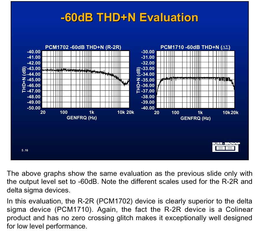

I can counter that with this excerpt from the BB seminar
There you are! This is exactly what I/anyone with the appropriate test equipment can do, easily. And we have poor levels of distortion at higher levels (than -60) as well. These are quit audible levels to me.

These are audible levels to me.
Completely empty, unsubstantiated claim.
Charlatan.
se

There you are! This is exactly what I/anyone with the appropriate test equipment can do, easily. And we have poor levels of distortion at higher levels as well. These are audible levels to me.
THx-RNMarsh
Those graphs are for R-2R vs DS. You have a DS DAC in your system. Haven't you just said that your system is suboptimal by your own rules.
dac Lynn likes multibit.
