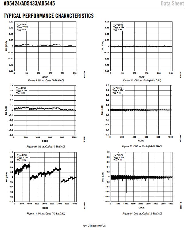

It is very difficult to trace the root of any acoustic difference. Proving it (to yourself) is even more difficult.
In practice the INL and DNL limit the performance and more bits do nothing.
Attached is an example where more bits worsen INL and DNL.
http://www.analog.com/media/en/technical-documentation/data-sheets/AD5424_5433_5445.pdf
Identical DAC architecture, different bit depths.
And these are R-2R DACs, much by audiophiles (whereas Delta-Sigma DACs are )

I use the DAC used by BenchMark-2. measured at least 21b in practice.
A bazillion people have been doing this for awhile ---- download a 24b/96+ played into a very good D-Sigma DAC and to a very clean PA and low distortion speakers or headphones. Use a CD from the same recording and compare the performances. It really isnt hard or any tricks involved. If there is an improvement/more accurate then why is that?
