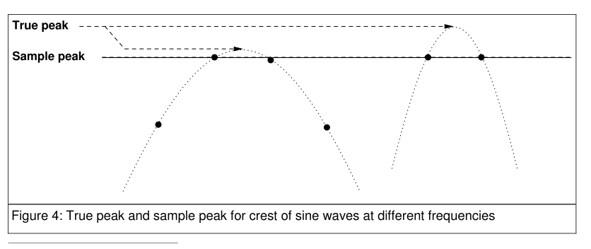

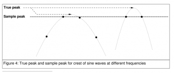

All meters, analog mechanical by definition or led electronic have some form of averaging which means in practice that short term and more especially very short term peaks are not truly represented.
Mechanical VU meters are the classic overload error causing level indicator in the hands of inexperienced operators, followed closely by PPM level indicators such as the BBC 7 (don't go over 6) scale.
Even sample peak metering is inaccurate, see diagram below...
bbc.co.uk/WHP202.pdf.
Peak_programme_meter
The only real and correct level indicator for digital audio is DAW waveform display, or level calibrated real time oscilloscope monitoring analog signal lines.
With all the averaging PPM metering standards in current use, it is no wonder that modern recording methodologies and final master results are in such a sorry mess, particularly in the hands of operators who do not understand visual metering standards behaviours and limitations.
