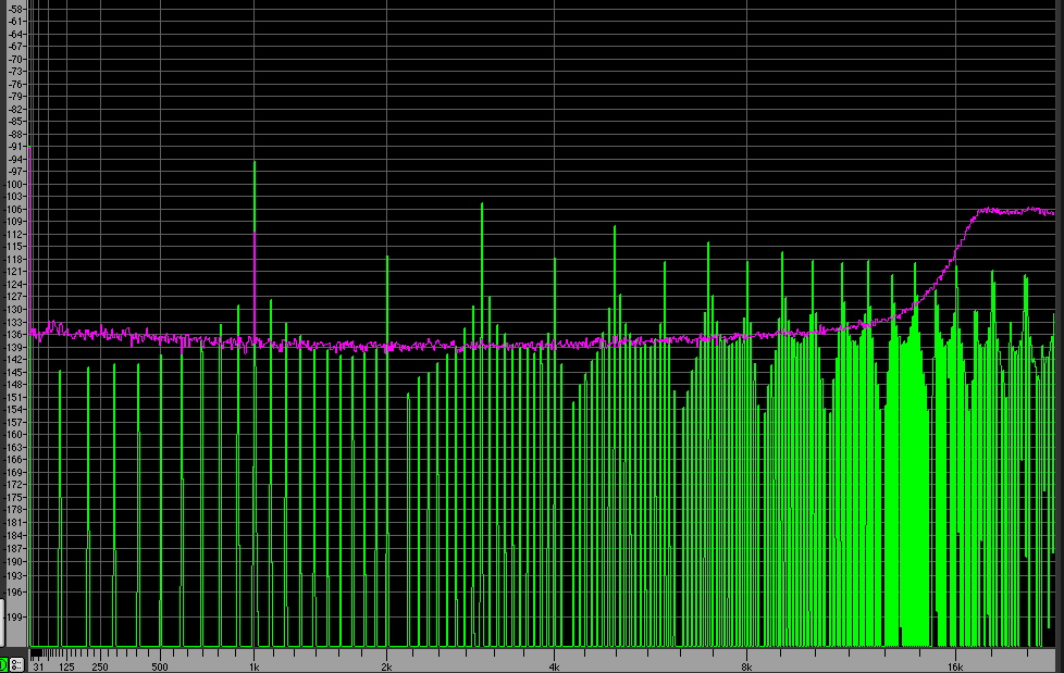

jn,
every CD/DVD/SACD playback device, with exception of few very early CD players, contains some DSP 'block' that does manipulate original data in one way or another. Digital oversampling filter, either external IC or built-in into latest generation DAC ICs, is one such typical example. It receives 16/24 bit data from the media and performs calculations (oversampling, low-pass filter) on that data in HIGHER resolution than the data itself - i.e. it does it in 24/32/48 or even 64 bits.
Now, the output of such DSP has to be calculated down to the wordlenght that the external DAC IC or DAC part integrated into IC can accept. This is a bottleneck of the system and it is 20-24bits, or, very rarely, 32 bits wide. This is where the dither 'at the user end' comes into play (one more time), if one doesn't want round-off errors.
Here's the dithered 997Hz -110dB 16bit file spectra superimposed on the -110dB 16bit file spectra where no dither was used during 24 to 16 bit conversion. The process run 'native' in 32 float.
Please note that the -110dB signal is not at -110dB mark anymore (!)
This equally apply to any DSP out there.

I figured eventually someone would provide an explanation I could understand. Thank you very much, from this old dog..
