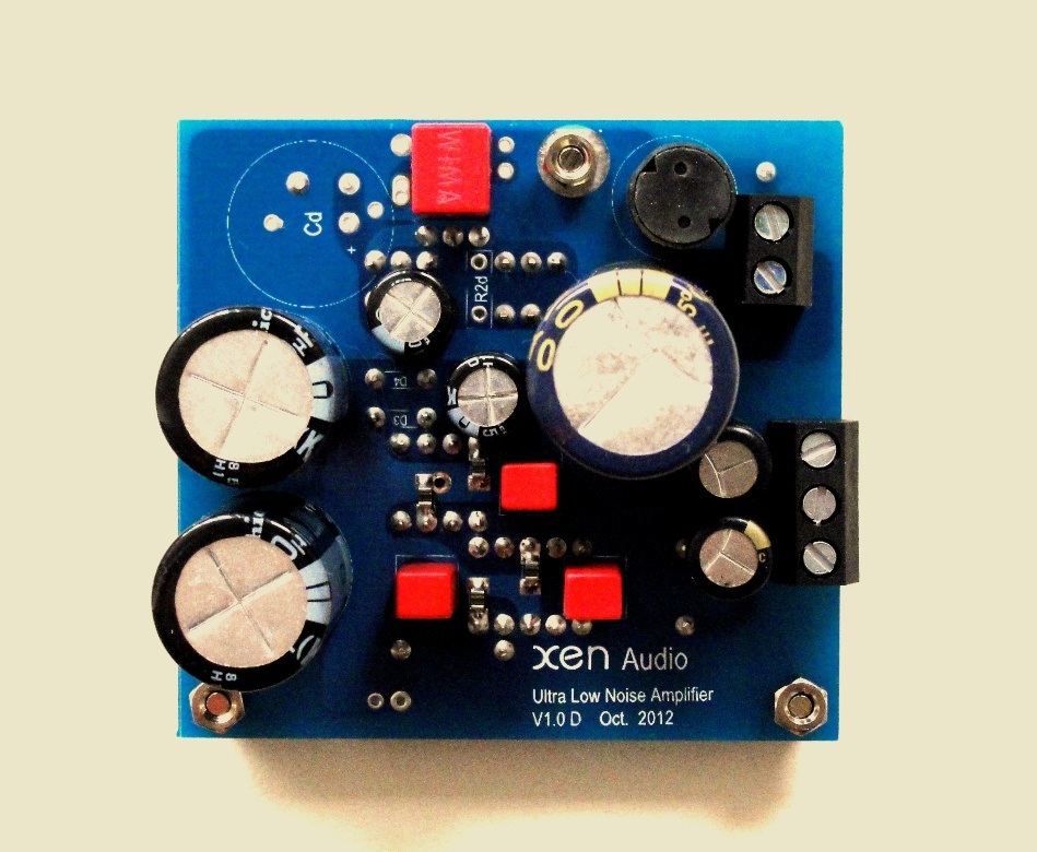

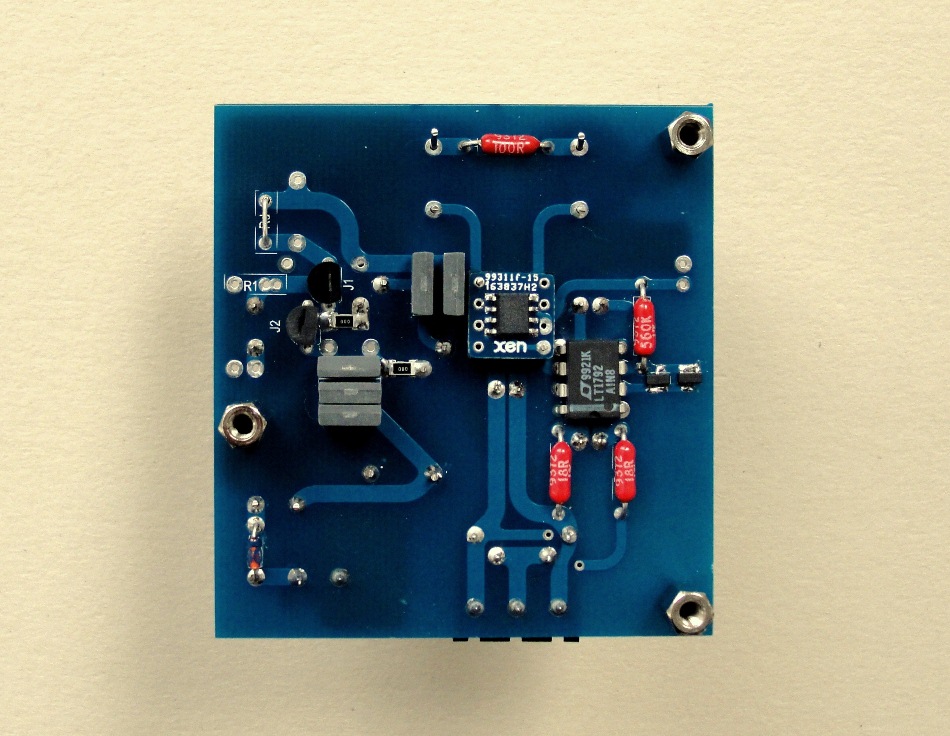

> we are trying to do a crazy low noise FET amp and sneak it under the radar of the current establishment......
I think you did not mean AD8429 ?
150nA input bias current does not sound like FET input ??
I have built a 12000x low noise amplifier with a Felix Levinson front end followed by an AD8429 with 100x gain.
(No where near as clever as your circuit using the VO1263 for bias.)
The original PCB was designed for SSM2019 before I found out about the AD8429.
A small conversion board did the trick ......
Nice chip, the AD8429.
Patrick
