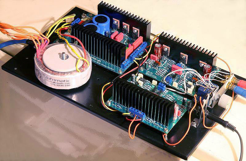

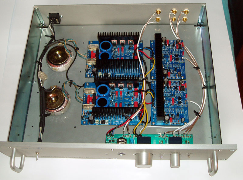

So? You should start worrying when the output devices have to start dissipating something like 3W, even on demand only.
True, you will have the added hassle of heat sinking them locally, which does add cost, needs more space and prohibits really small size, but for a standard 19" 2HE case, that's not a problem at all.
And, judging from my own experience, deep class A (where the bias current dissipation exceeds the maximum required by the design by a factor of say 1.5 at least, preferably 2) does have its sonic rewards, believe me. It's a quality which trascends pure measurement, but it's obvious enough at first listening.
On picture 1, a close up of the prototype I developed the headphones on. Left two heatsinks are for the shunt PSU, right two cool off the output stage.
Pisture 2 shows the dual mono final form version. As you can see, still quite a bit of space left.
