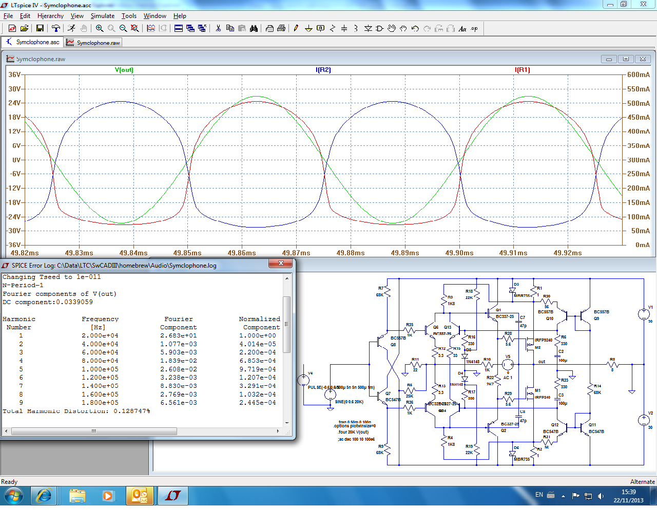

Usual definition: sum of the currents through the two OP transistors constant, and no one ever turning off.
Original definition: an amp where each output device conducts 360 degrees of the signal cycle.
Which begs the question: an amp where the output devices conduct less than 360 degrees, but do not turn off due to some residual bias, is that a genuine class A amp?
jan
jan
In my opinion it is, as long as there are no 'sharp' edges in the curves (see LA Cube-Law amplifier).
But it is not according to the definition (cube law is, as both polarities conduct 360 degrees of the signal).
Another way to look at it is to look at the supply currents. Class A, including cube law, has supply currents that resemble the signal. 'Fake' class A, like class AB with a non-zero switch-off current have supply currents that look more like class B 'pulses'.
This is important as a large part of the sound quality of class A comes from the fact that the supply currents don't have the high level of harmonics that can cause audible degradation in non-genuine class A.

A reminder:
Class A: both polarities conduct for 360 degrees of the signal
Class B: each polarity conducts for 180 degrees of the signal
Class C: each polarity conducts for less than 180 degrees of the signal
Class AB: each polarity conducts for more than 180 but less than 360 degrees of the signal
Jan

Good news: this means that all my Circlophone, Synclophone and Symclophone are now upgraded to class A, while I designed and described them as sliding class ABOriginal definition: an amp where each output device conducts 360 degrees of the signal cycle.
