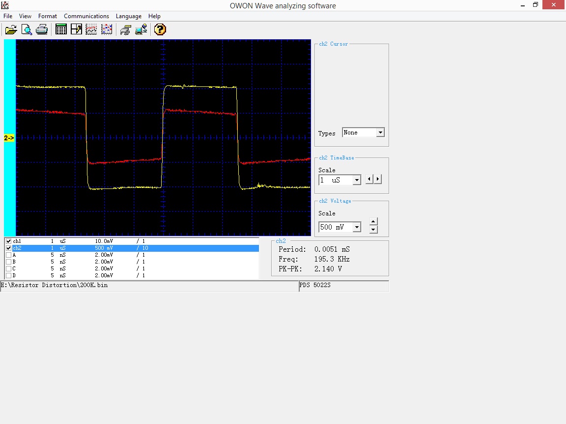

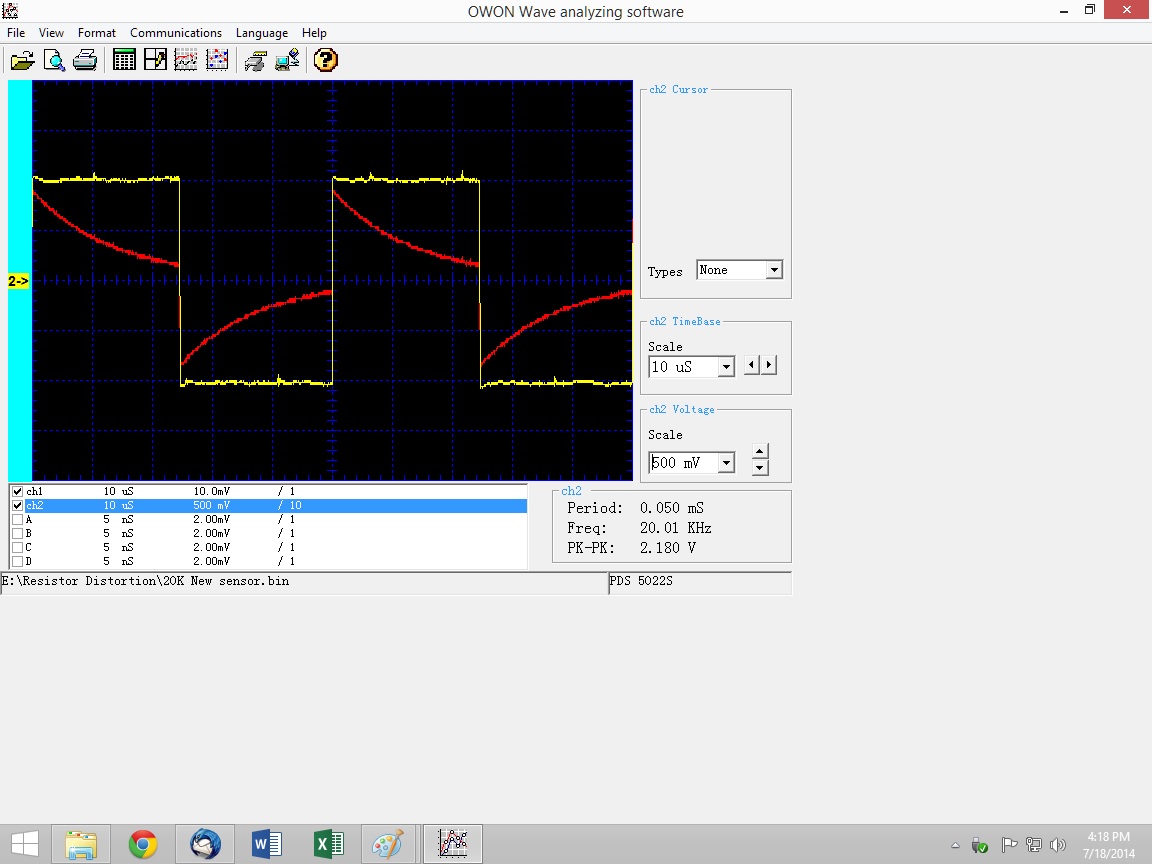

Bonsai posted a really cute toy. All I can do is show the results of my latest miniature current monitor. It goes low enough in frequency that my Tek Hall effect unit will cover anything down there and goes higher than my current function generator and from the square wave response probably is flat to 20 MHz.
The yellow trace is the voltage across my current source 100 ohm resistor.
Now, what is the precise schematic of what we're looking at in the two waveforms?
And when are we going to see some diode recovery waveforms??
Nice work Ed..
Nice work Ed..

My current transformer is loaded by a 15 ohm resistor nothing funny. Yellow is the voltage across a 100 ohm resistor the red is what the current probe shows when the resistor lead is inside the probe.
