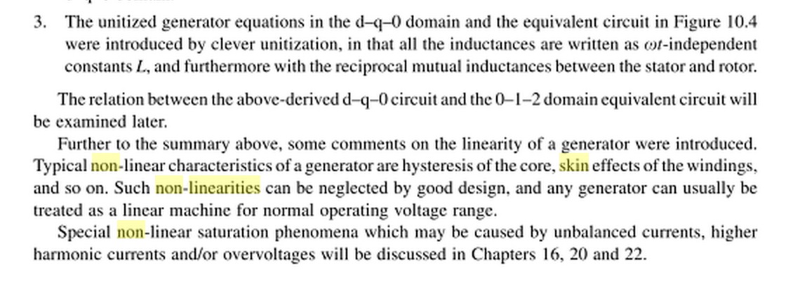

That simple cut and paste was for a 60 hz generator, and the proximity/skin effect nonlinearities are many orders of magnitude beyond signal stuff. Making widgits which rely on very high levels of dB/dt, high currents, and driving non linear loads is not the same thing.Non-linear as in creating harmonics? The 17Mhz ADSL+ profile would be pretty much do-do if the magnitude of this was above the noise.

No, just the simplest. There were quite a few well above your "pay grade" as it were, but you didn't understand what was presented so far. (quite a few of the articles and books were pay as you go, so I "went".So Googling for nonlinearity and skin effect gives a 60Hz generator as the clearest result?

You didn't find the text I did the screenshot of? A generator uses normal copper (ordinary).
