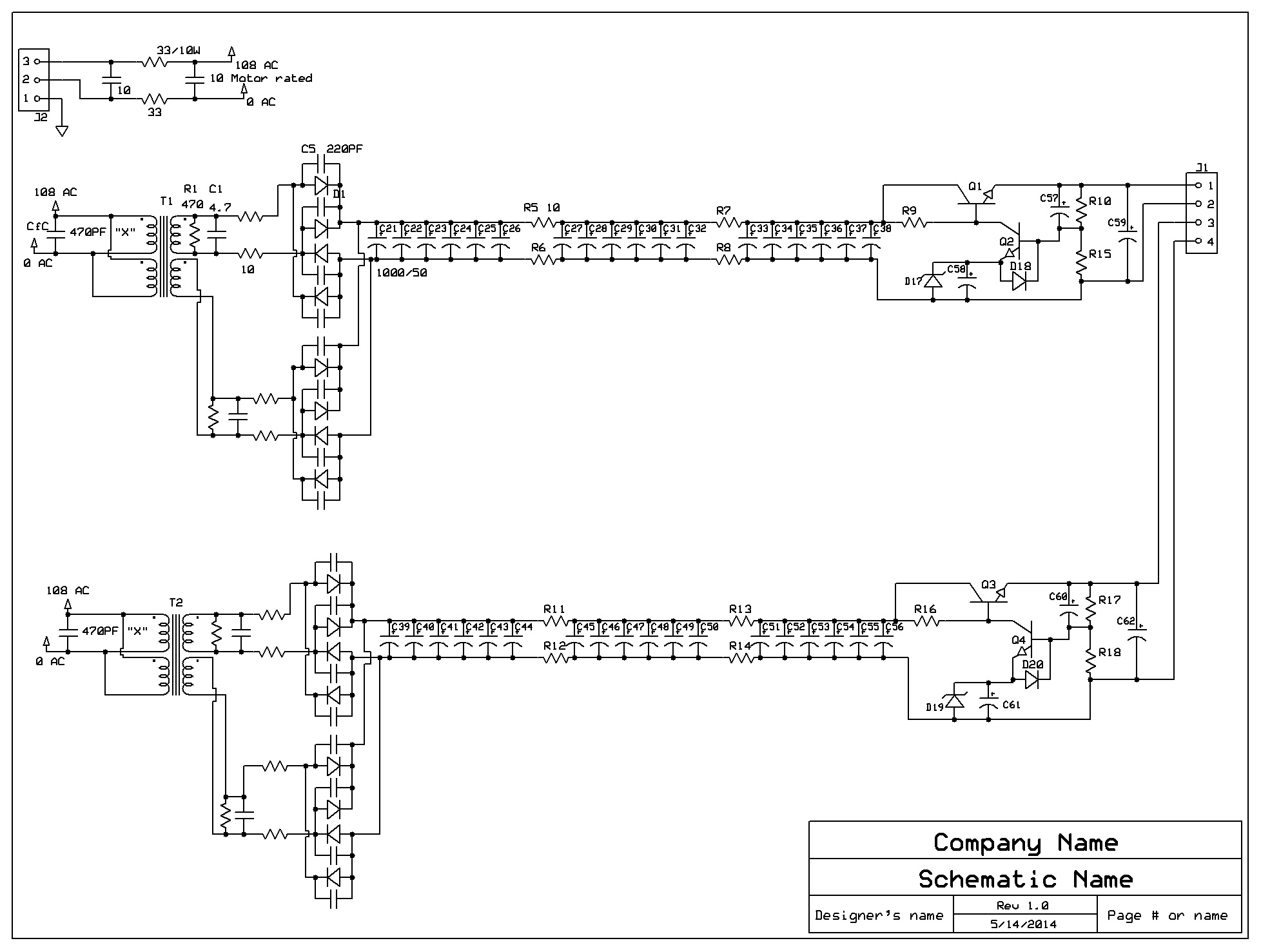

Like this for a low noise preamp power supply. I use one of these in my JC3 clone. I hear no power line artifacts even with my ear nest to the loudspeaker.
P.S. J.C. doesn't like this design it is too complicated. Sometime soon I will finish tweaking it and post measurements. The goal is to be quieter than a battery.

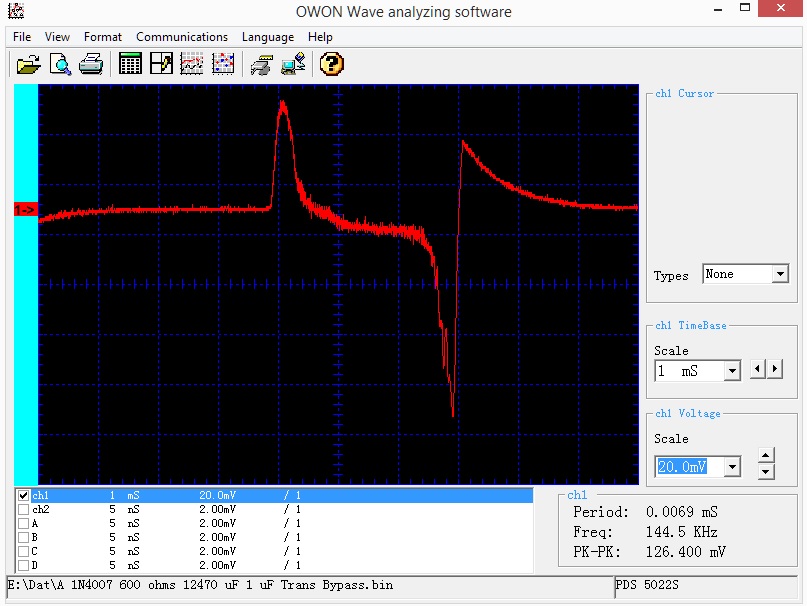

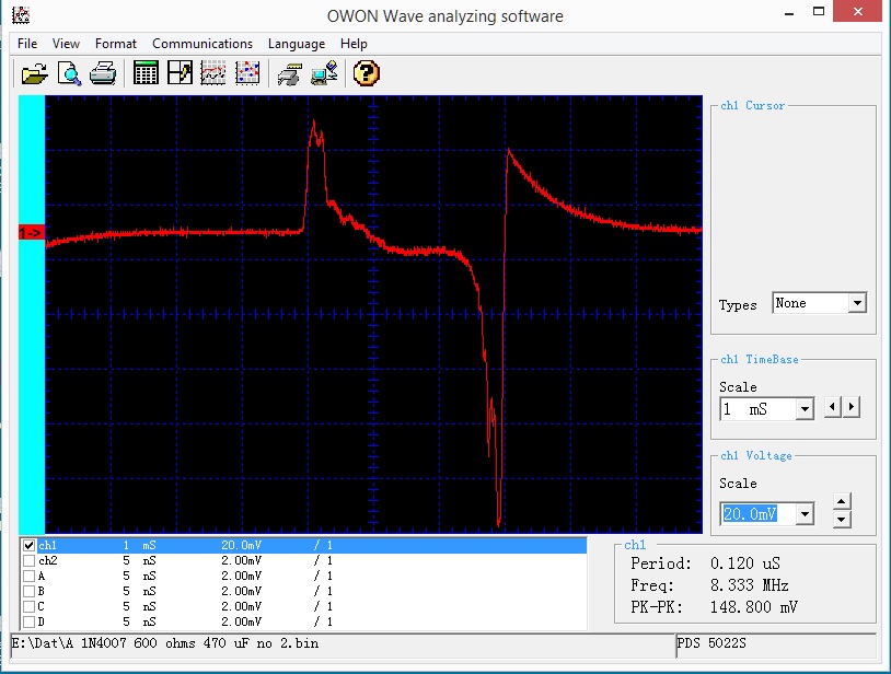

Attached are three shots of 1N4007 diodes in the test setup. First no snubber, then a 1 uF snubber across the transformer secondary and last snubber with 12,000 uf more capacitance. traces offset high by two divisions to show largest display possible. Ch. 2 looks at AC out of transformer to get trigger.
Note that even with the much larger filter capacitor the charging current is the same.

  • 1N4007 24 V Torroid 600 ohm Load 12470 uf Filter 1uF Transformer Bypass.jpg
Ed, that is a good supply, but it takes more time and effort to make, because it has so many parts. IF the cap quality is essentially similar, I would concentrate the caps to a simpler configuration, and add common mode chokes.
Actually I could use fewer caps and they should be different values at each stage. But I will wait to play with that when I finish building the equipment I need to properly test a supply that works this poorly.
Hi Ed
Is your system ground completely disconnected from mains ground, connected to mains ground or decoupled somehow from mains ground ?
When putting a cap across the line / mains, I found that adding 1R in series measured better in spice and sounded better in reality - although, with all those decoupling caps in ur supply you may not notice any difference - but other equipment connected to the mains may be affected by the resonance. The second line cap is decoupled from the line inductance so the 1R is not needed.
I try to avoid any circuit that could generate a High Q resonance.
Hi Ed
The transformers are on an internal chassis that is then insulated from the outer case. This gives me an IEC & UL compliant insulated system. The current code is aimed at eliminating the ground connection from consumer gear.
Some time back I did an Audioxpress article on setting up a resonant circuit on the AC power line. The circulating currents were enough to melt the resonant capacitor tuning switches rated at 30 amps. So adjustments had to be made with the power turned off. So your suggestion of a small resistor in series with the first capacitor seems to be a good one.
