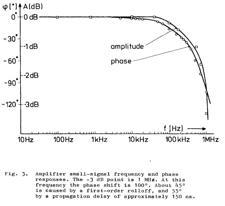

I can’t find the design doc that is mentioned in Fig.3
(Page not found | Linear Audio NL.)
(http://www.linearaudio.nl/Miscellaneous/lohstroh pp.pdf.)

What causes this “150ns propagation delay” ? (pages 11, 17, 21)
http://www.linearaudio.nl/linearaudio.nl/images/pdf/otala%20low%20tim%20amp.pdf
George
You need the phase vs. frequency plot. IMHO this is an old school way of looking at excess phase, lumping it as a prop-delay. There is no way this amplifier has no higher order poles at all.
I have not met again a prop delay expression in an amplifier ‘phase vs freq’ diagram.
Fig.3 is such a diagram.
The fig description makes clear that LP filter and prop delay are two different contributors (acc. to the authors).
The fig description makes clear that LP filter and prop delay are two different contributors.
George
You need a linear with frequency plot that goes out much higher in frequency. In the very least the low ft devices of the day would have base charge storage that would contribute phase in a distributed fashion. Let's just say IMO the author's simplification is naïve.
Scott, I don’t disagree on what you say in both of your posts, especially with the “base charge storage that would contribute phase in a distributed fashion”.
But then look at their Fig. 8. Phase compensation is distinct from the fixed -frequency independent- delay compensation element.
I would say they didn’t try a simplification here. I suspect a fundamental disagreement around the ‘f word’ (their page 6 'i' para ?).
If memory serves, the output devices were quite fast for the day (they are relatively medium power, not the sluggish 2N3055-type high power devices). That's why there are 2 pairs for just 50W Pout.
I think they were 30MHz Ft devices.
