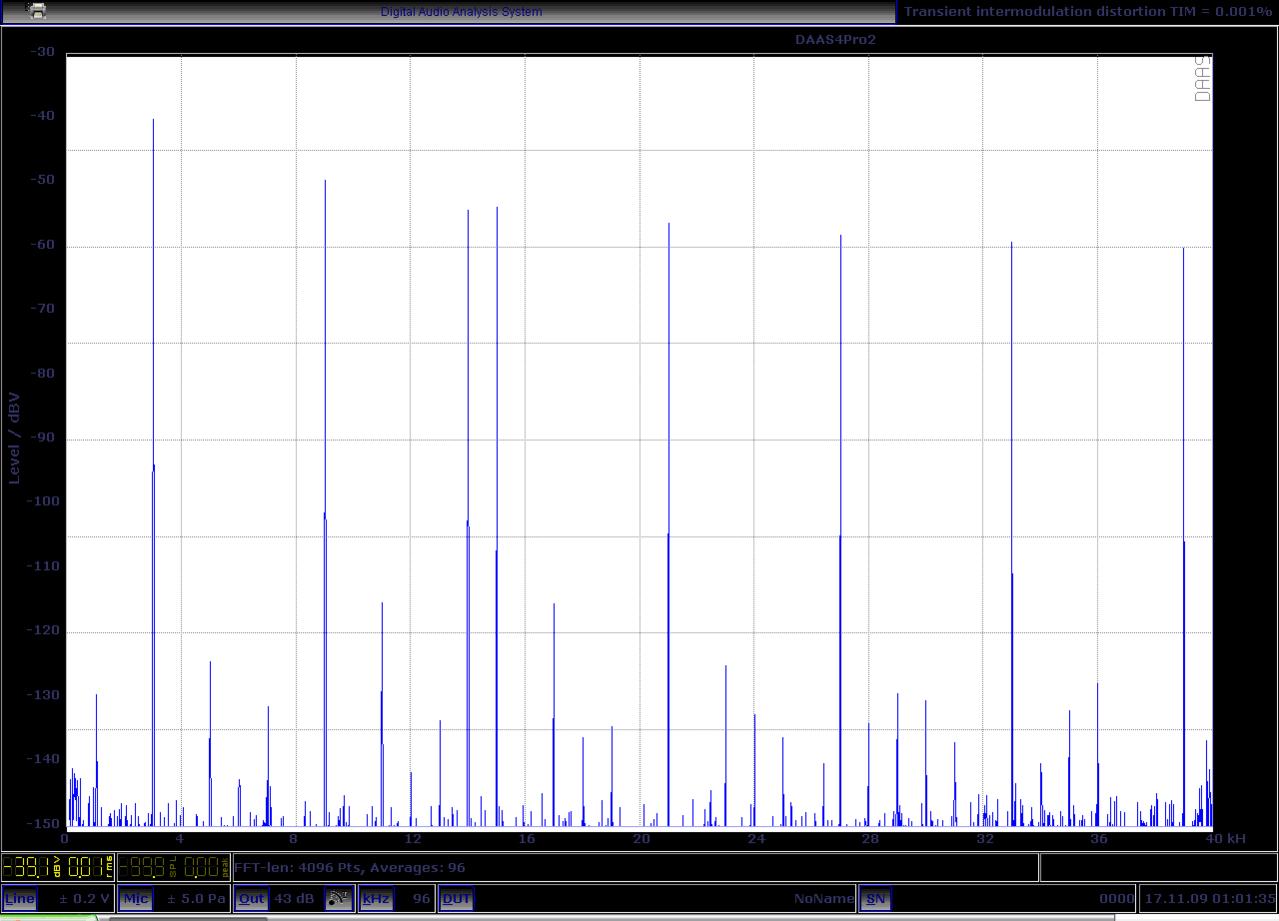

I use the Belcher test all the time. Also notched noise and TIM square.
Problem is that it does not reveil anything new in linear electronics that a conventional measurement does not show.
For codec´s and speakers it is very usefull though.

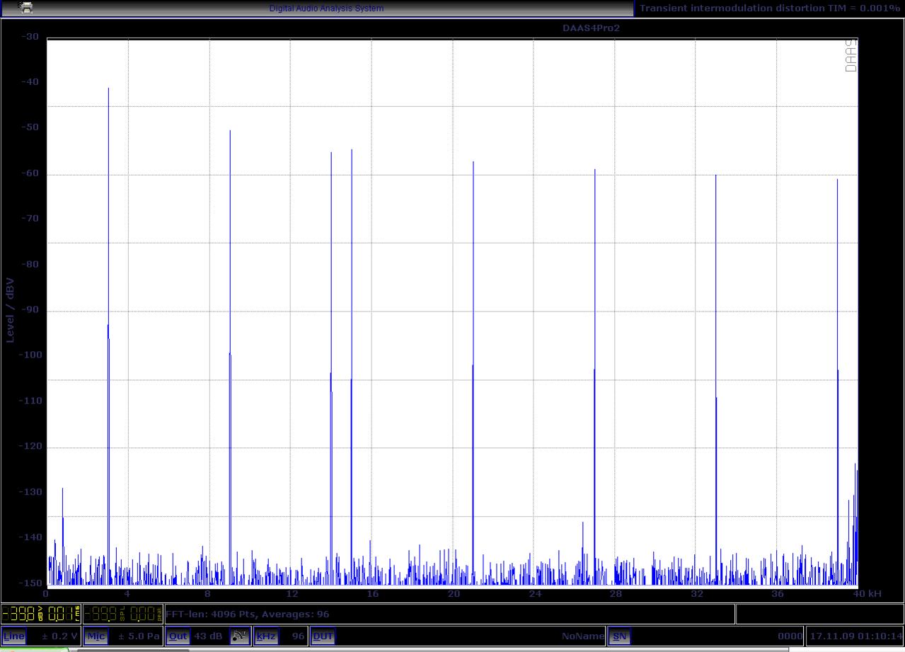

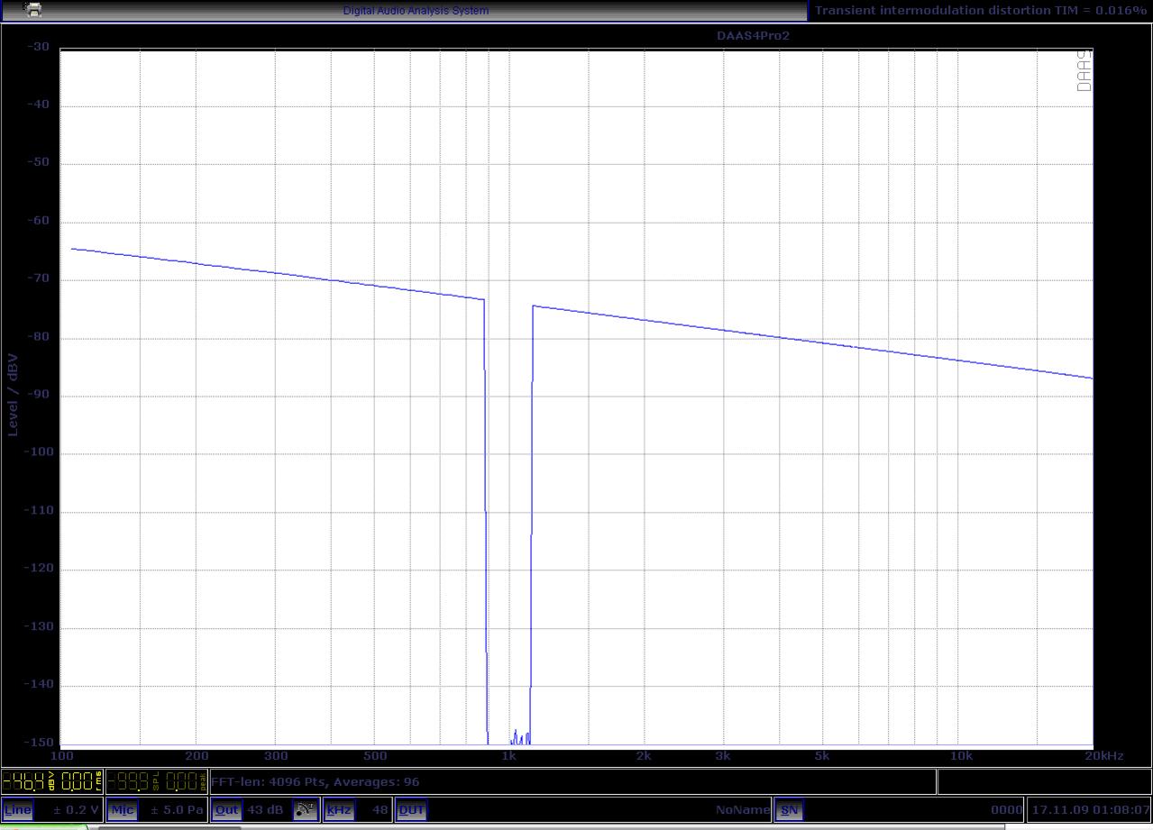

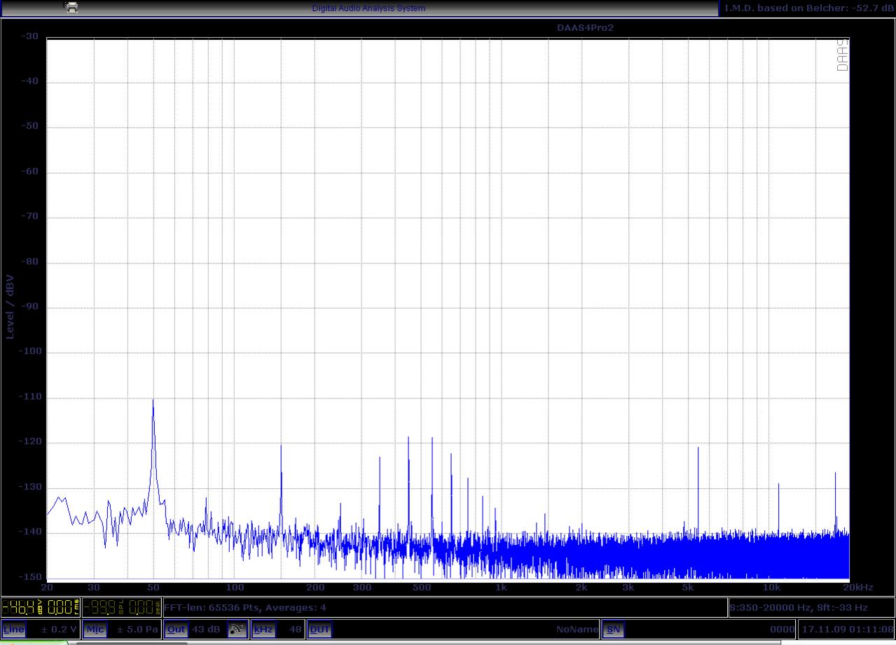

Here you can see some shots i made from the bespoke AD797 intrumentation stage i mentioned. There is some life under -120dB but if that is audible i do not know.
The first picture is the noise notch, then the Belcher test and then the TIM square method.
The last picture shows an open loop JFet phono input. Here you can see some distortion and also a lower noisefloor then the AD797 ( paralleled ) stage can manage.

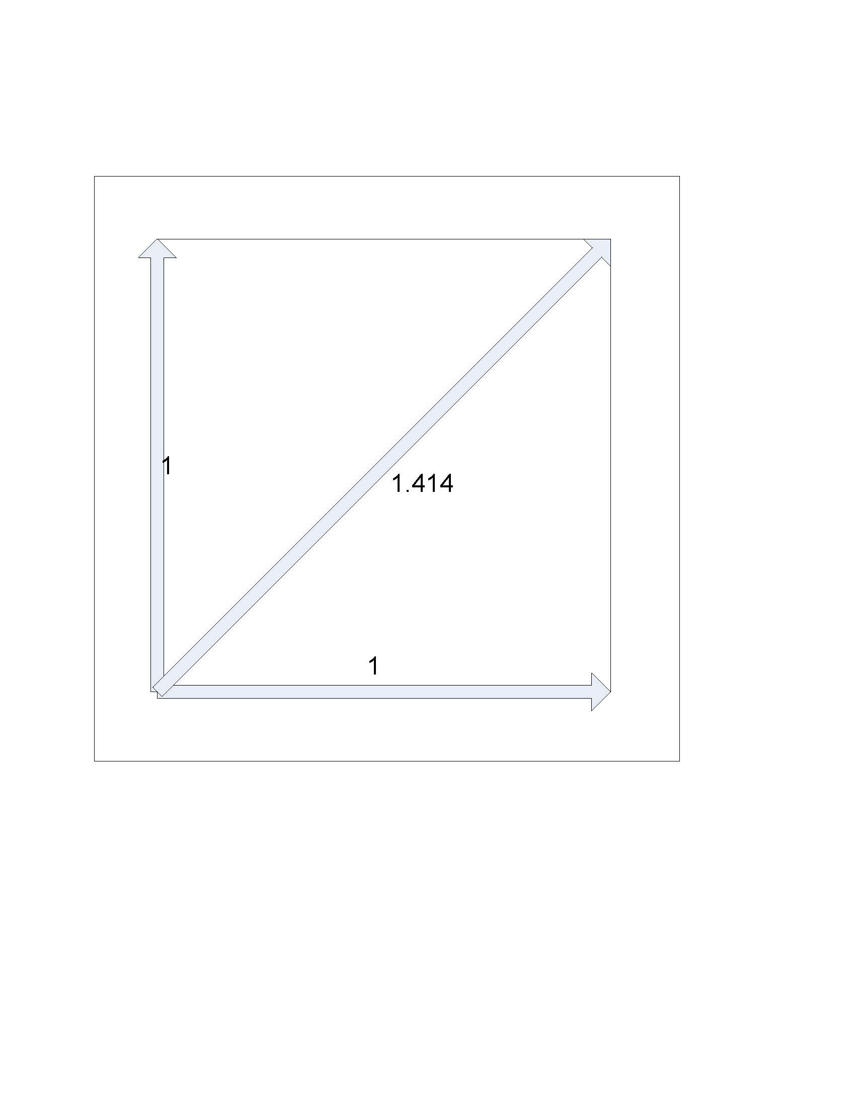

I have to put my math hat on some times and think these things through. I understand practically about the non correlation factor but not sure how that would work mathematically.
It's fairly simple: power, not voltage.
Got it Sy,
Thanks, Steven
One plus one no longer equals 2.
