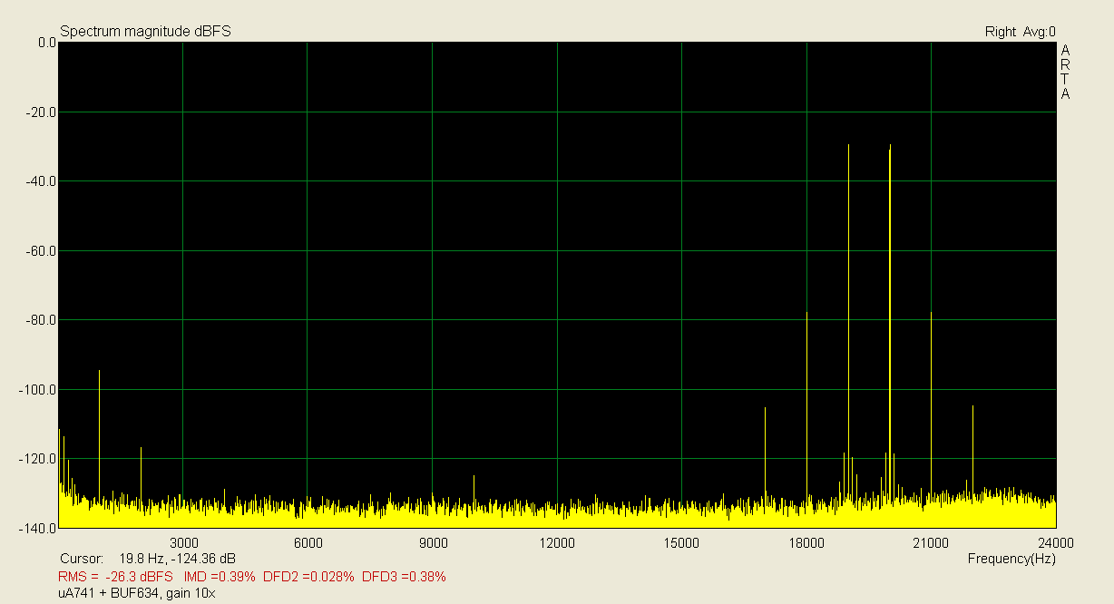

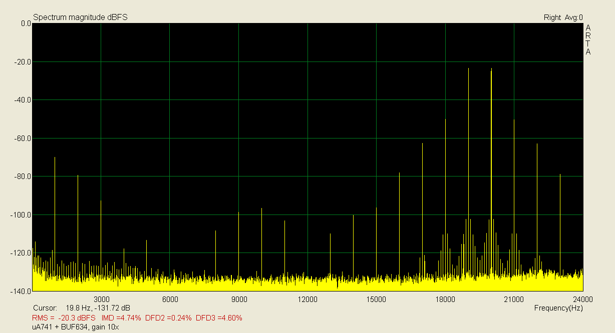

Maybe John could add something on white noise measurements, since his old results are widely mentioned in the literature
"The distortion specifications obtained for several operational amplifiers by a variety of test methods have been compared by Leinonen, Otala and Curl.
Please spare us going back to how poor 741's are in audio. At some point these historical perspectives deserve to remain footnotes and nothing more.

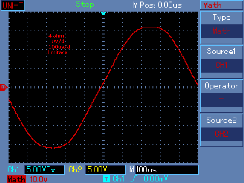

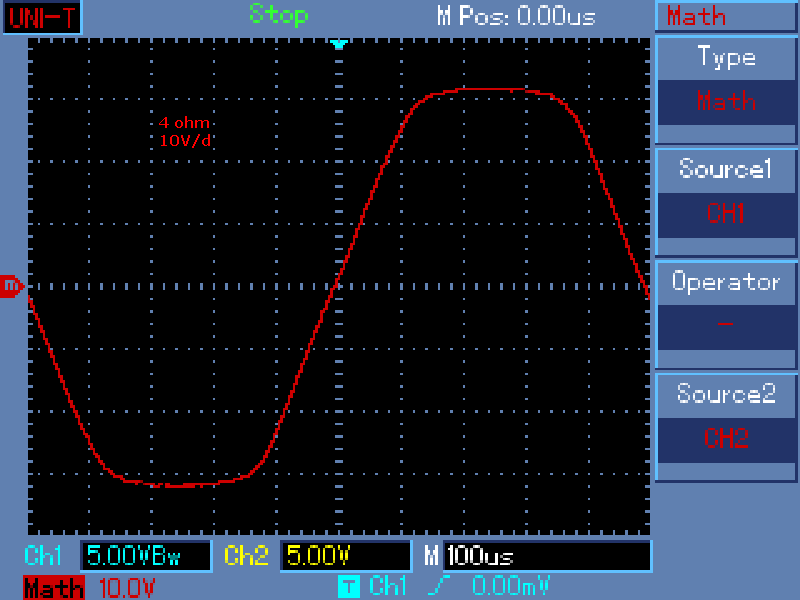

Vladimir, in case of 'soft-clipping' like this (no GNFB amplifier) the borderline where distortion rises is not sharp. In case of white noise measurements, you will see lower distortion (in the transition area) because of smooth clipping. Anyway, it says nothing about quality of the amplifier.
I am sure this is a hopeless wish
