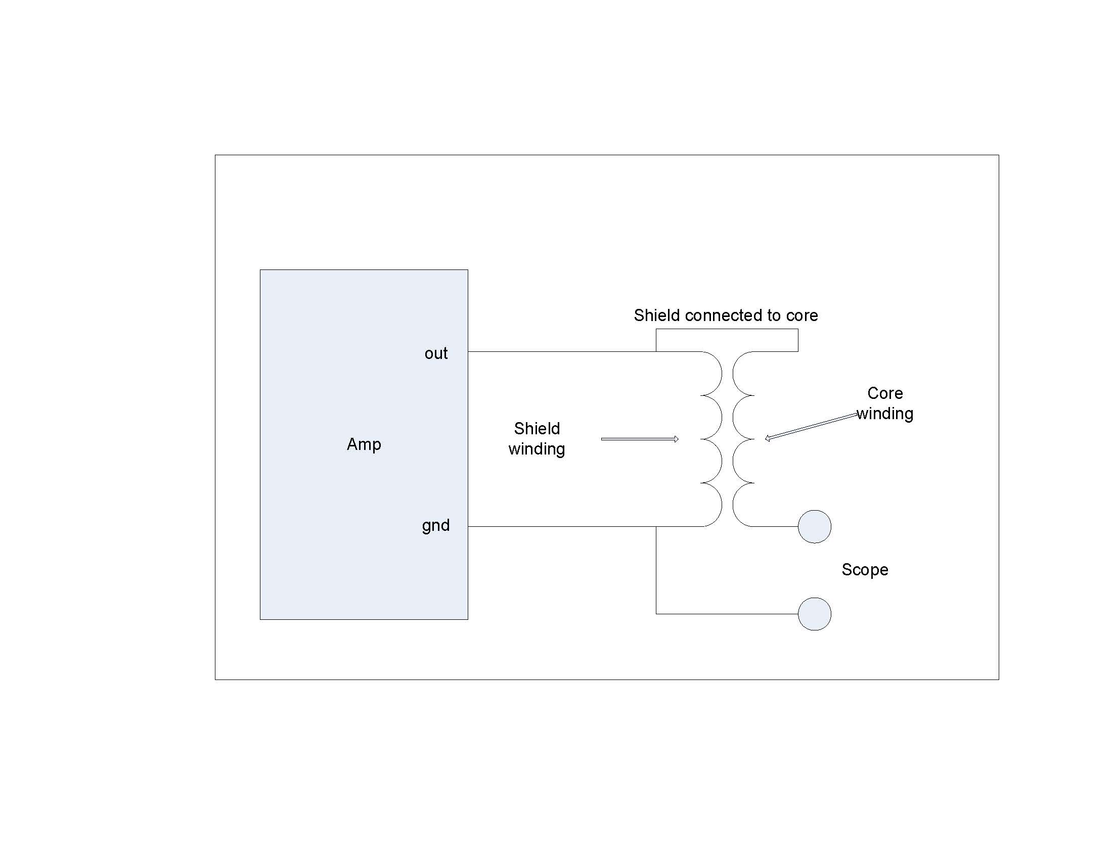

Why don't you try this: get some small diameter coaxial cable with a braid shield. Make an air core inductor by coiling it nice and tight. Try for about 2 mH.
Measure the inductance vs frequency by using the braid only. You will find the region where the braid's Rs starts to climb. Measure it out to Rs=20 times the dc value.
Repeat this measurement using only the core wire. You will find that Rs will hold off its increase out to a higher frequency. The smaller diameter of the core resists proximity.
Now, for the actual test. Connect a power amp to the braid and core at one end of the coil. Return the power to the amp via the shield only. Sweep the sine from a low freq to the frequency where the Rs of the shield is 20 times the dc value.
Measure the core's voltage to ground (shield return) using a 10 x probe to prevent loading. (you are measuring primary to secondary voltage difference with secondary unloaded.)
What's the waveform look like? It is the IR drop of the shield.
Scott knows this test design.
edit: I have the test schematic elsewhere, but no access to it at the moment. Any Q's, please ask.

Here's the test design.
It's setup so that there are no equipment ground problems, and there is no need for a differential measurement.
If you use too low an inductance value such that you have to go very high in frequency, then there will also be a capacitive coupling inherent in the dielectric of the coax to worry about. While that in itself is purely a linear coupling, it can confound the result simply because it is coupling a distributed primary voltage along the entire length of the winding. Nonetheless, if there is a proximity induced dI/dt squared effect, that will show up in the IR drop of the shield.
