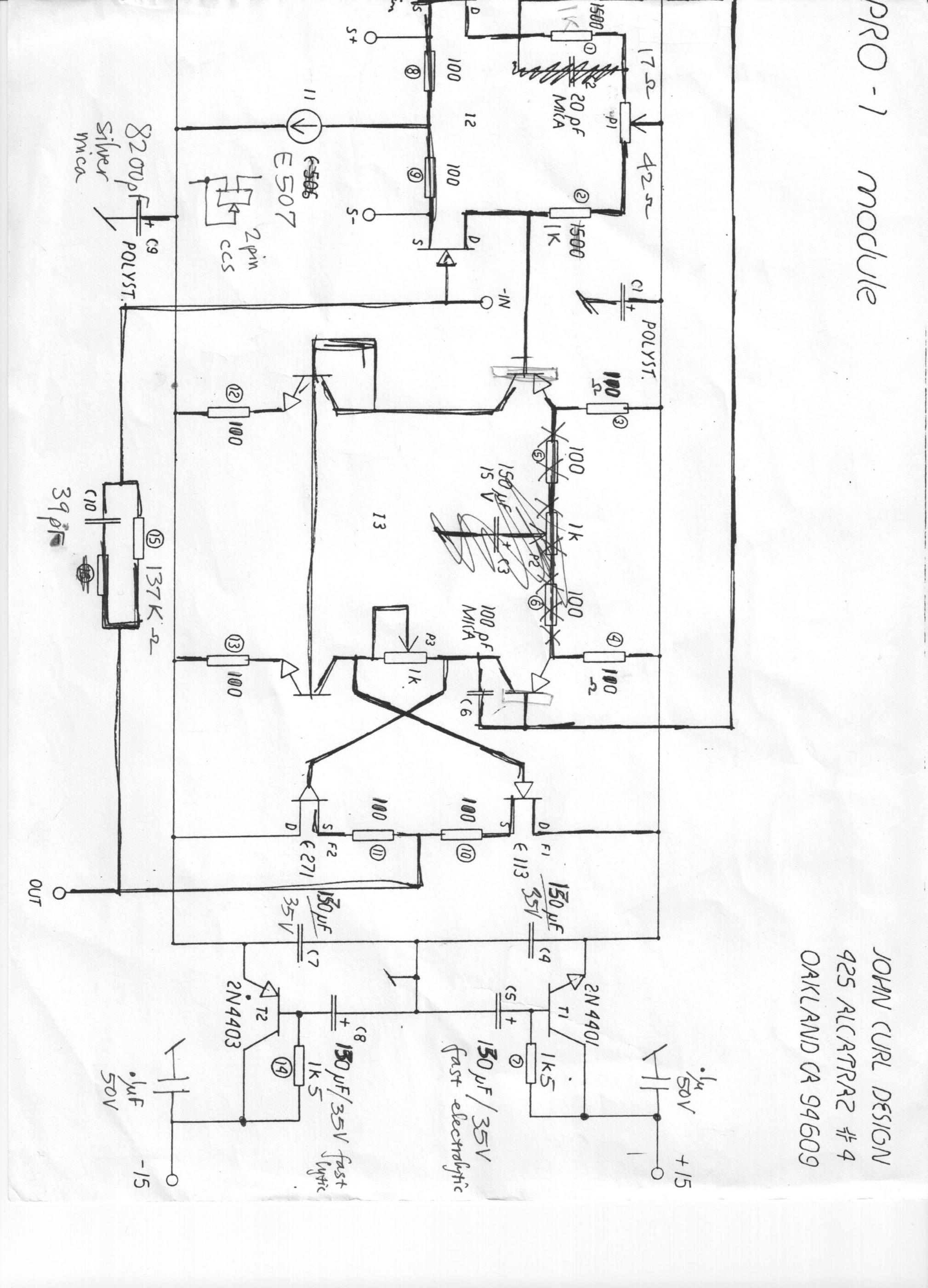

This is an example of distortion differences with a Hirata test.
Look at this schematic of a discrete op amp made more than 35 years ago:
NOTE the crossing out of the AC distortion cancellation circuit in the middle of the schematic. The HIRATA test showed me that this added feature generated Hirata distortion, and removing it eliminated any Hirata distortion, although the sine wave or IM distortion was then slightly higher. That is what I might call an 'exotic' or 'advanced' measurement, and this is what I want to concentrate on in future.

No response from anyone? It is not just this 'exotic distortion' that we have to test for, but it is a good example. Once I knew what to avoid, I didn't have to make Hirata tests, but trust me, many other amps and preamps would measure badly. This gives me a design 'edge' that started 40 years ago. If you want to be a champion of audio design, you must take these sorts of distortions into consideration.
