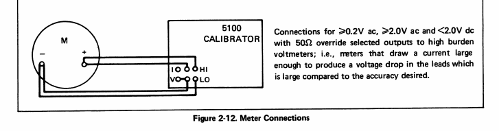

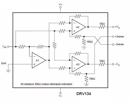

For John or anyone else versed in Feedback theory. What would happen if we took a third wire back to the speaker terminal and used this as the end point of the feedback loop for a power amplifier, the end point of the gnf point that was used to feed the input node? This would include all wire parasitic value and would get you to the point where you would see the back emf coming from the speaker terminal. Would this have any advantage over the current method of leaving the speaker node out of the feedback loop?
The usual term for this is remote sensing (I'm surprised no one has pointed this out yet). its often done with high power DC power supplies. Its also standard practice with precision AC calibrators. Below is an illustration from the Fluke 5100 manual. its not that exotic or rare, just not normally necessary. Cello also attempted this in some of their products.

Its hard to implement because you end up with essentially a zero ohm impedance at the sense point and you can easily run out of phase margin with a reactive load. The calibrators all have effective current sensing disconnects to protect them. Mine will work with 10' cables for both sense and drive pretty well as long as the load isn't too low Z. Above 100 KHz it bypasses the remote sensing.
Back emf sensing works well but isn't a universal application thing to do. You need to optimize it for your system. I have done back emf sensing and servo control on woofers with great success (Entec) but that was a closed system.

Stability can be had if you transition to local (as opposed to remote) feedback at RF. Most amps will require an L//R between the feedback point and speaker to snub series resonances, which are an Achilles' heel of voltage-output amplifiers. Ironically, this network may have more impedance than the cable itself.
An amp can be designed to not need the L//R, but this is difficult and IME is not a very flexible approach.
But, this is all academic unless you know there is an advantage to remote feedback. We don't know whether the distortions at the end of the cable are adding to or subtracting from the actual distortions of the loudspeaker, so I would only use remote feedback if there was a known accurate motional feedback source.

The Kenwood amps worked fine. It's just that there's no real advantage to it unless you have very long wires and/or very pathological speakers. Two sets of extra cabling to get a few hundredths of a dB of improvement in frequency response just doesn't seem worth it to most people.
