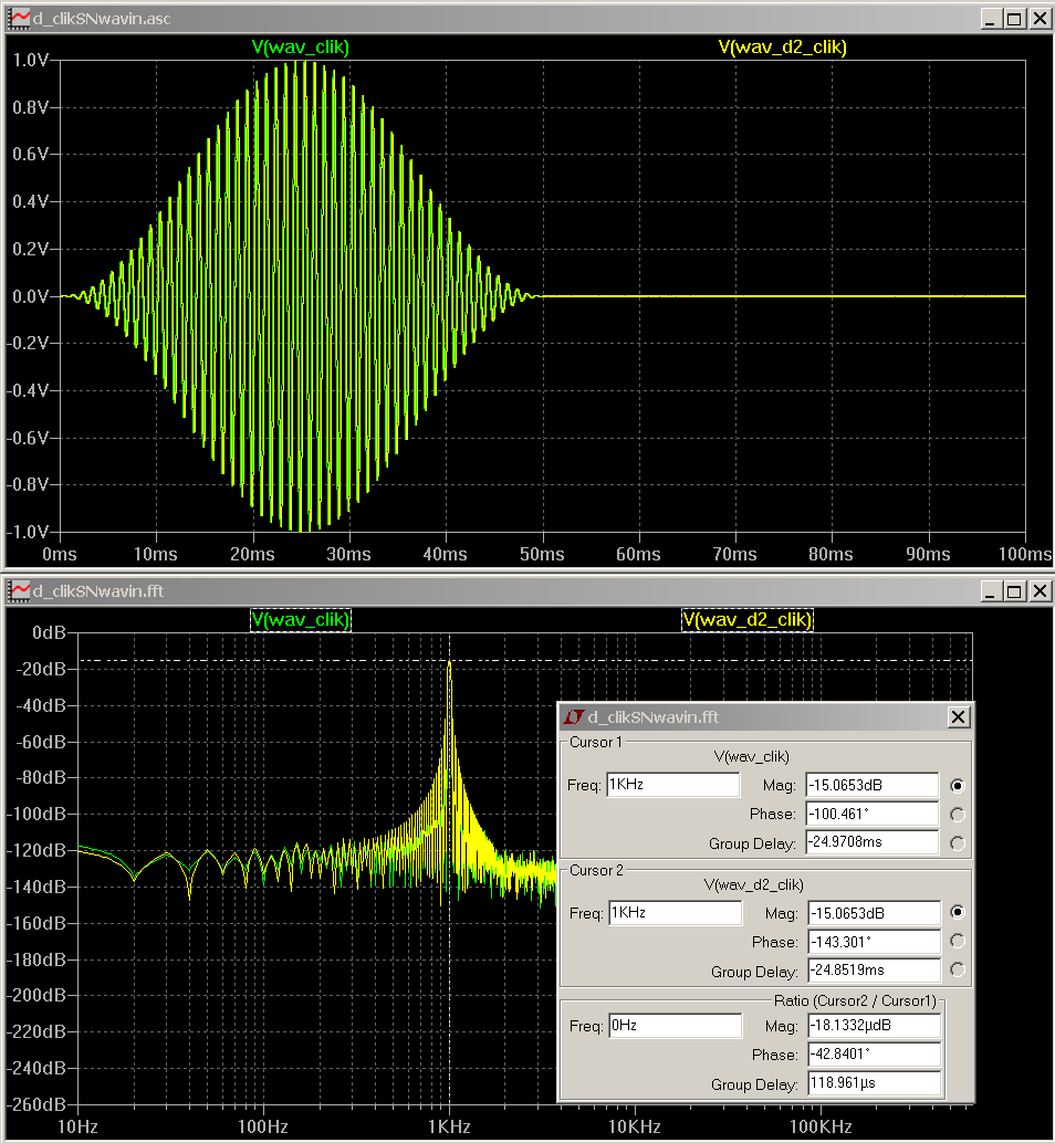

From 3 years ago. j.j. on time resolution:
To the sampling issue, it is simply false that one can not reproduce an ITD smaller than a sampling instant. In fact, we can resolve, at 20kHz, for a "Redbook CD", a time resolution proportional to, and very near 1/(2*pi*20000*216) in a mechanical fashion. This shows, I think, that sampling is simply not an issue (please note, per Shannon, the absolute absence of the sampling rate in that equation beyond the knowledge that the sampling rate is sufficient to reproduce 20kHz). Arguing that one needs 500kHz because of interchannel time resolution due to sampling is simply wrong, period. Arguing that you need 500kHz bandwidth, likewise, is just wrong.
it seems this just doesn't get through to some people
RedBook CD has plenty of bits for nanosecond resolution

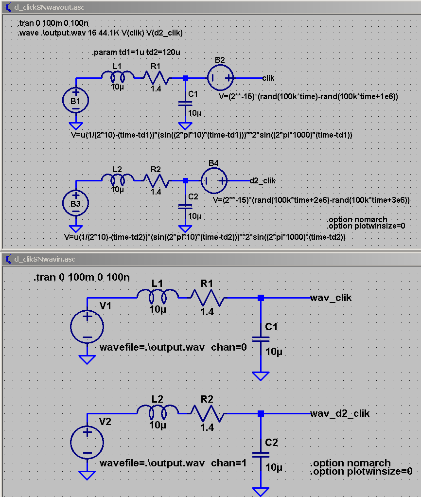

this can be simmed - like I have with the dealyed clik tone bursts before when Kunchur's lack of DSP prowess has come up
LTspice - free, already used by many here
below I have created 2 50 ms raised sine enveloped 1 kHz tone bursts: B1, B3
they are dealyed by td1-td2 = -119 us
added 2 lsb pp TPDF dither (B2, B4), then write out both to a 2 channel .wav file at 16/44100
the next asc reads the .wav, then I run a fft on the burst wavefrom
the cursors are set to the peak at 1 kHz
calculating from displayed phase diff of -42.8401° / 360° * 1 ms = -119.000278 us
thats sub nanosecond resolution folks - encoded, transmited through a CD resolution .wav file
all the moving parts are visible, you can play with the sims yourself
(LTspice group delay calc seems to have a rounding? error - looks like I'll be emailing mike)
just to see it wasn't dumb luck I can change the td2 value to 12 us for a diff of 11 us - which is pretty much halfway between 2 samples @ 44.1k
-3.96005° / 360° * 1 ms = -11.000139 us
again sub nanosecond temporal resolution - just coincidence?
things you can try with the sims - edit the BV for shorter, higher frequency, lower amplitude - say 5 ms of 6 kHz at -20 dB: -23.7746° / 360° / 6 kHz = 11.007 us
that's 7 ns error due to shorter burst and lower amplitude showing limiting with dither noise floor
