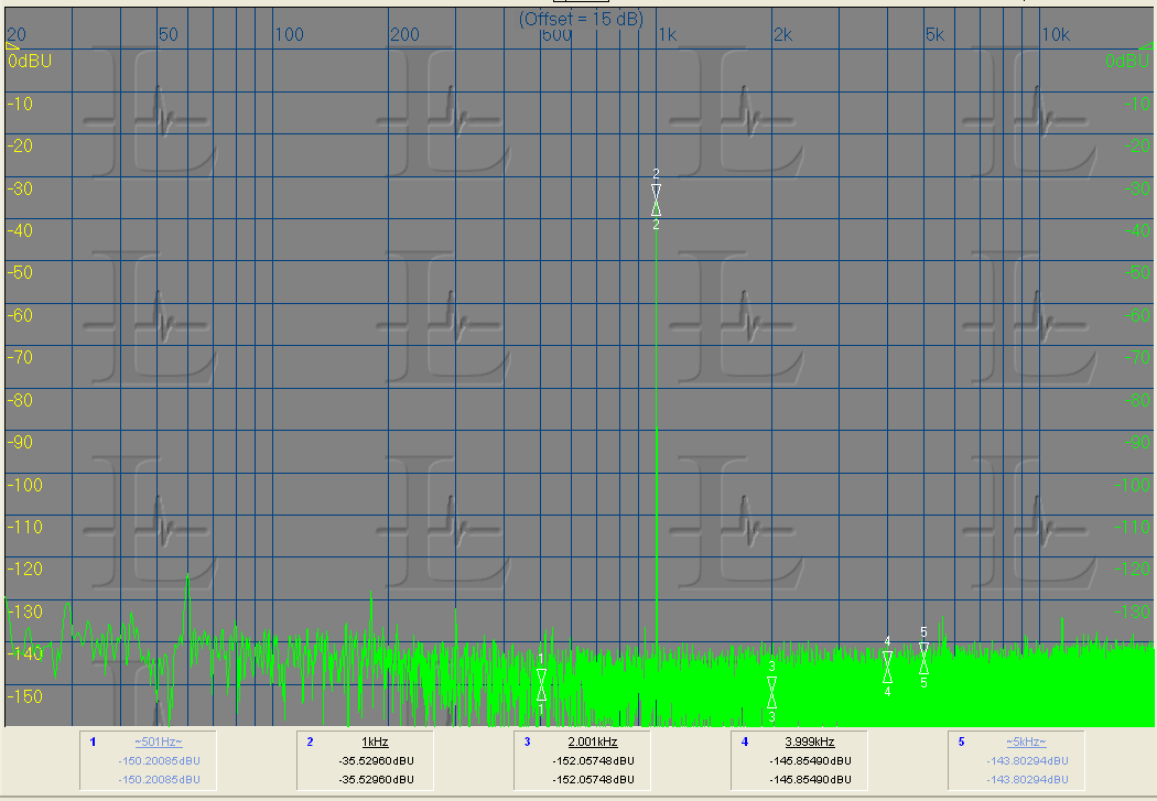

I set up the multitone test you mentioned to see what I can discover. I did not find a smoking gun yet. The IM/HD products are below -115 dBC at every level I tried.
How did you go about measuring this -115dBC level you mention? If you used some averaging then bear in mind the noise tends to be impulsive, its crest factor will be rather high. ISTM our ears are sensitive to its peak level, not average.
They do change with level but the peak at -115 to none clearly identifiable above a floor of -125 at approx -36 to -37 dB drive seems pretty innocuous. I will need to do more work to make sure of what I'm looking at and further document it. If you have more ideas on catching this please provide them.

The -115 dB is referenced to the peak levels in the individual bands of the excitation signal. Not the peak level or full scale. FWIW I'm using 13100 point FFT at 48 KHz. I will try various methods of capturing what is coming out to look for intermittent peak noise levels.

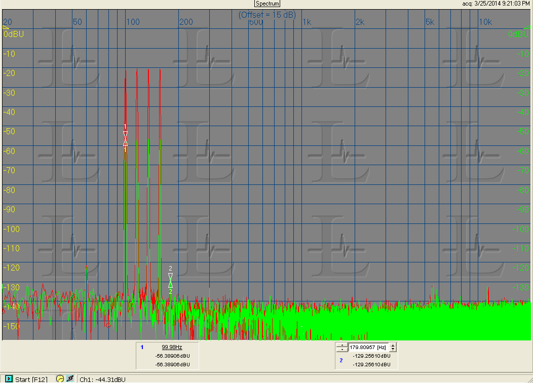

Rather than eyeball estimations of noisy baselines I'll post some pictures that will help. My point was actually that signals consistently below -115 dB are not that important. No transducer I know of could possibly reproduce them. And, checking my calibrations this evening, the actual level was -130 dBFS. I will be more careful in the calibrations going forward. The 4 tones are all selected to have no common harmonic or IM relationships so they will be maximum stress in that sense.

Picture 1- -35 dBFS and -36 dBFS superimposed. Picture 2 low frequency multi-tone at two significantly different levels, -20 dBFS and -44 dBFS. Both pictures; one capture 131,072 points, 48 KHz, no averaging. Source Picture 1 Altor digital generator, picture 2 Praxis via EMU1616M. Capture in both cases EMU 1616M and Praxis.
