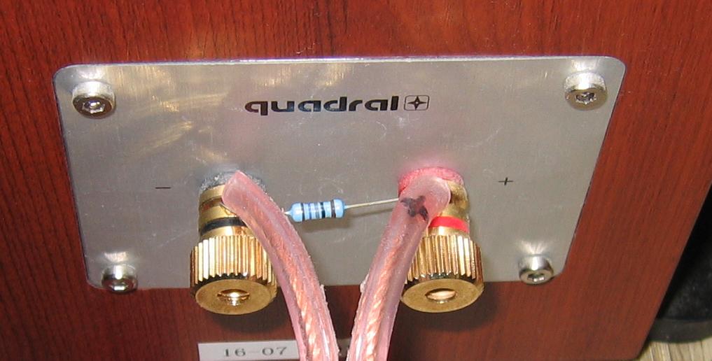

I was only speaking about the long cable to the speaker.
A common practice, at least to some of us.
What is the value of the resistor?
It might be 68 ohms. It wouldn't be much lower, or it would be too charred to read the bands...
That's it. And it works. Resistance is close to cable HF wave impedance.

I can, pavel I hope you don't mind..
When the load "unloads", or goes above the cable's characteristic impedance, the cable will look like a capacitor to the amp. This resistor guarantees that no matter what the load does, the termination at that end will never be above the cable's impedance, so the amp will always see either inductance, or resistance.
For rf, it guarantees that there will not be cable resonances as a consequence of reflections.
The caveat is, if the cable is a low z type, that resistor would be too low a value, and it would consume power. When the cable is very low z, you'll have to put a cap in there as well to protect the resistor against lf power.
For that thickness insulation, I would guess around 120 to 150 ohms.

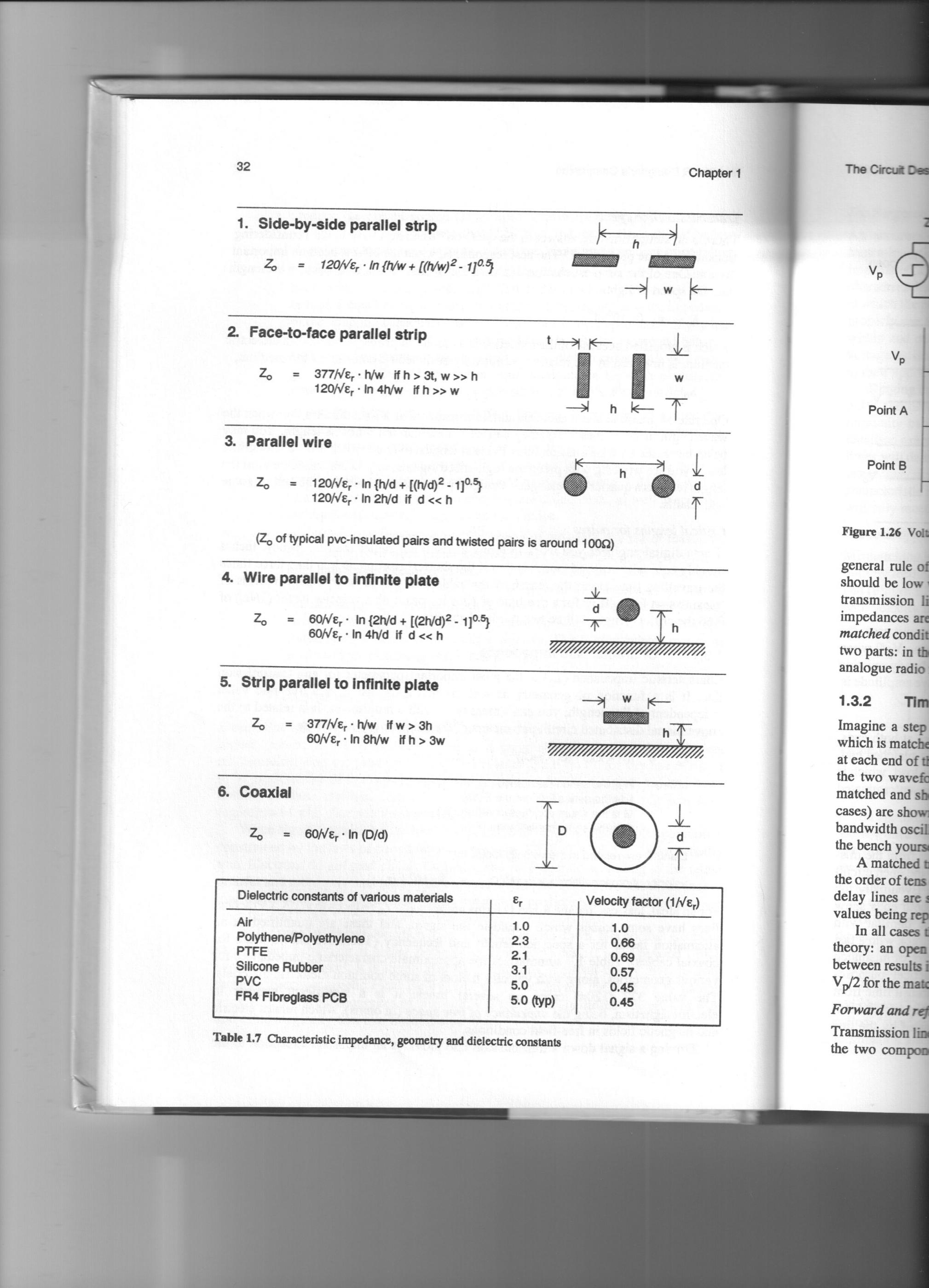

Is there a simple way to determine the value of the resistor if you knew the impedance of the cable and the length of wire or is this a complex mathematical equation or do you have to have specific analysis equipment to determine the correct value? Would you also need to know the capacitance of the cable in question?
jn
What insulator thickness? How to relate that to the 168 Ohm used? Do you mean cable diameter?

Ya Mon !Ideally, the value of the resistor should be the same as the characteristic impedance of the cable.
As should be the output impedance of the source .....

Hmm, we usually put such compensation in the xover , is this the same or different effect and is this why MIT cables have that little box ...
PS: that resistor is color coded , why is everyone guessing its value......?
