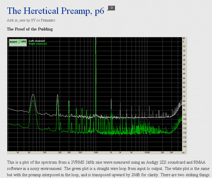

And I do not follow you. You care about precision of passive components and then you use them in mediocre valve amplifiers and get mediocre measurements like this. You care in passive precision is not helpful here.
