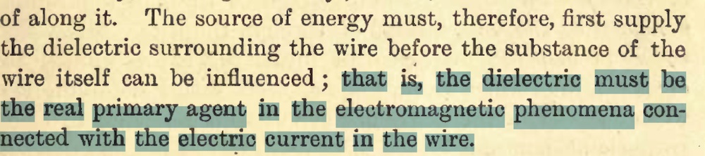

From the Heaviside links provided earlier...
This old chestnut gets dragged up from time to time. Try feeding your speakers
a) with just the uninsulated wire (ensuring that no shorts develop),
b) with just the wire insulation but no conductor.
Which one makes louder music? Hence, which one supplies the energy for the voice coil?
One could regard this as an example of the Poynting myth.

My interpretation was that when a wire conducts something, it depends on the dielectric surrounding to do so - be that surrounding air or som other material. My conclusion was that the surrounding (isolation) has impact. It means that also your case b) is dependent on an surrounding dielectric to conduct (anything) even if it is a poor conductor as you imply.
A wire conducts a current because the electric field in it applies a force to the free electrons. All the surrounding insulator does is define the boundary of the wire. This assumes the quasi-static model, which is appropriate for virtually all audio situations except trunk telephone lines. The dielectric surrounding the wire begins to play a part as frequency rises. Even then, most of the insulator around a wire is normally air (which behaves almost the same as a vacuum) as the dielectric is usually thin. The dielectric causes a small reduction in propagation speed.
