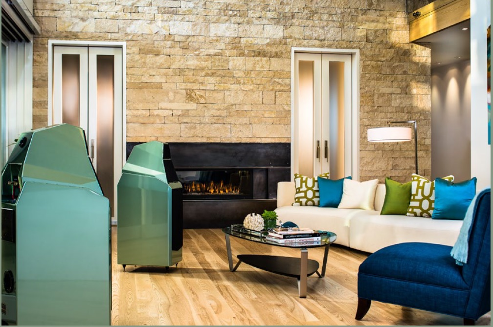

I have found that this 'series' of loudspeakers from the WATT1 to the Sasha works for me to reveal the subtle details that make differences in audio electronics most easily audible.
Another way is direct driven electrostatic microphones, which I also sometimes use.
An excellent counter-example is the Sequerra Met7. I got them cheap! And I have used them 10 times more than the WATT's over the years. They do OK, but they are 'forgiving' and that makes them difficult to use for serious evaluation of other components.
Without acoustic reproduces of similar quality to the WATT's or the STAX headphones, I can understand why many here don't bother much with subtle differences in audio electronics.
Hope you didn't get the green ones John ........ :p

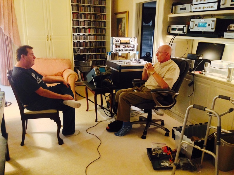

Is that the 'beast' in question in the background there, John?
I always thougt that yours was based on "VU" model , since they're so popular in US, but it looks like an "RC" to me.
Best,
