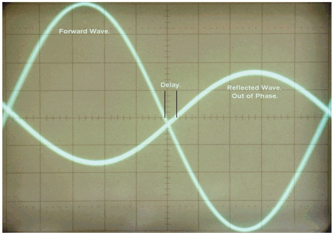

I vaguely recall figure 5, a scope photo,
Figure 8 of the paper from Cyril Bateman...
Cables, Amplifiers and Speaker interactions. part 1.
This is the scope photo. He states this is the reflection of a 10 Khz signal, so that makes the reflection 4 microseconds.
He used 4.9 meters of a supra 2.0 cable, 16 feet. The hf transit time for that cable is approximately 50 to 60 nanoseconds, which clearly does not explain a 4 uSec reflection.
Is the line load purely resistive at 10kHz? Or rather, does it have exactly the same phase angle as the line characteristic impedance at 10kHz? Only then will the reflection have the same/opposite phase as the initial signal. In this sort of thing you need to carefully distinguish between a phase shift and a delay.
To the non-casual listener, phase shift and delay are of no importance. Sound is. My test setup is geared to only measure the time difference between the voltage and the current at the amp as a function of the impedance of the load. The basic measurement problem is trying to get accurate zero crossing numbers at the single digit microsecond level with 500hz to 5khz sines.
At 1Khz, a 1 microhenry cvr generates an inductive reactance of 2pi 10e3 times 10e-6 volts, 60 milliohms. A 1 ampere sine into a 100 milliohm/1uH cvr generates 100 mV at zero phase, plus 60 mV at 90 degrees lagging.. Confounding the absolute precision. Raising the resistance introduces unwanted resistance at the amp, changing the entity being measured. That's why I believe a good cvr is required here.

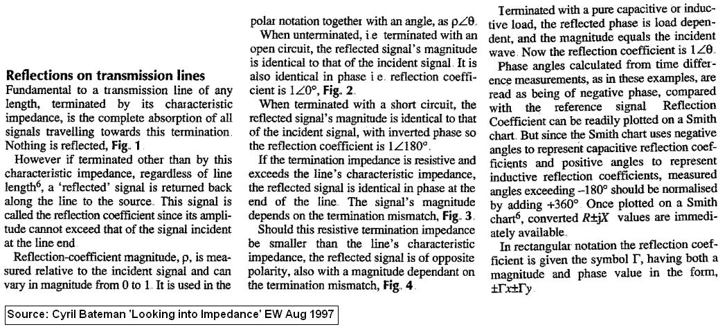

You'll have to read the article. Here is an excerpt from his article..discussing the scope photo I pasted.
Cables, Amplifiers and Speaker interactions. part 1., Cyril Bateman, page 6:
Cable Reflections.
At much lower frequencies reflections do still occur with mismatched terminations, but produce less dramatic impedance changes. Reflections at 10kHz using the Supra cable driving the ESP_replica load are easily measured using a reflection bridge, the basic tool of all RF measurements. The figure shows some 40% of the incident signal has been reflected, equivalent to a VSWR of 2.2:1 and returned out of phase to the source. For this measurement I used my 50W HP8721A reflection bridges.
jn
edit: Again, as Scott said, Cyril is gearing towards amp stability, whereas I'm concerned with how the variation in the voltage to current timing alters image reconstruction.
I'll read more tonight but Bateman gives the magnitude and angle of the load for that photo and it would be good to do a lumped R/L/C computation as a sanity check on delay vs simple phase shifts. From what I can tell his bridge works fine down to 0 line length and could also have the same reading with a simple passive lumped substitution for the load.
I wasn't listening to the 'scope display. You said 'delay'. I suspect a phase shift. Not the same thing at all.
Just to be clear: the reflection at the end of a line is only at the same phase as the incoming signal (or inverted) if the termination has the same impedance angle as the line characteristic impedance. At audio frequencies this is unlikely, as the line impedance is unlikely to be purely resistive and neither is the load. Which is more likely: a 4us delay in a rather short line or a 14 degree phase shift due to an unmatched termination?
The bridge shows what was reflected, energy returning to the source from the load. The line is about 2000 feet too short for a single transit reflection.
It's closer to standing waves.
jn.
I'm still puzzled why you described the 4us as a delay when it is a phase shift. You can get a phase shift from an infinitely short line which is misterminated.
hmm. I post a picture directly out of Cyril's paper, with the word "delay" put in the picture by Cyril, and you ask me why I describe it as a delay?
You do understand I quoted from his paper, right?
It's not me your arguing with. I'm the messenger.
jn
