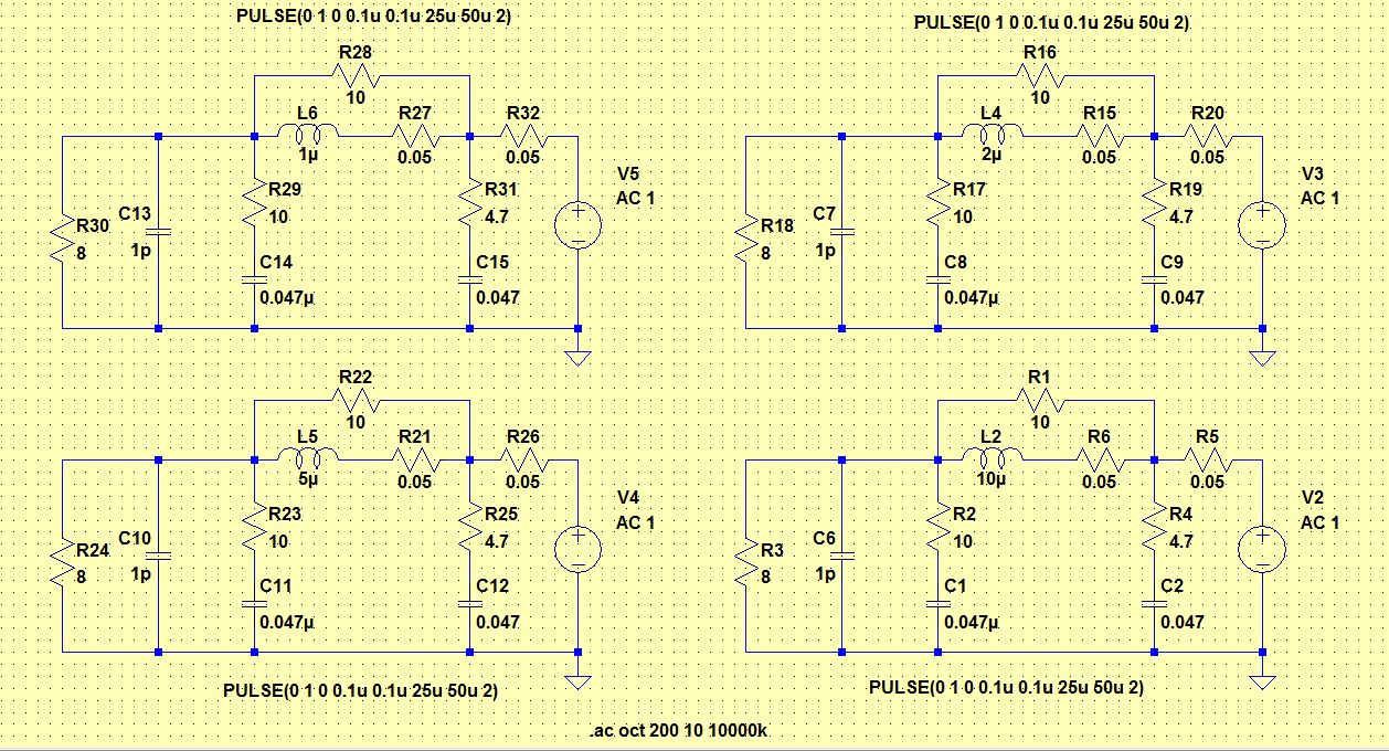

Dan,
Do you want 8ohm load ?
What choke values you want ? 2uH, 5uH, 10uH ok ?
Thanks Mike.Dan

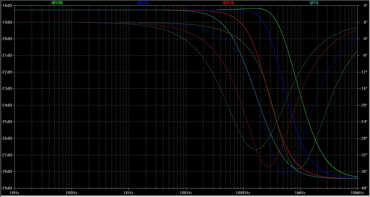

Is this what you wanted ?
I was/am interested as per recent discussion to see effects with differing loads.
Also discussion of advantages or not of this network, as opposed to standard output circuit.
Dan.
