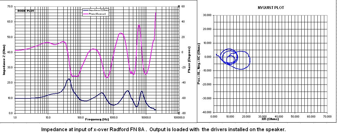

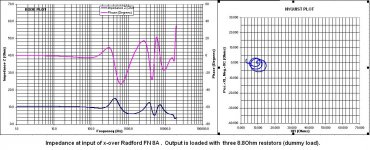

There are commercial amplifiers that behave very badly when loaded with capacitive speakers (electrostats) or another non-resistive load. Some compromised designs expect they will see resistor 4 or 8 ohm at its terminals. One of the reasons why purely resistive test load does not reveal much. It also splits theoretical designers who play with sims only from real word designers and experimenters. I also agree that a large output coil is bad thing and that it reflects incompetent designer.

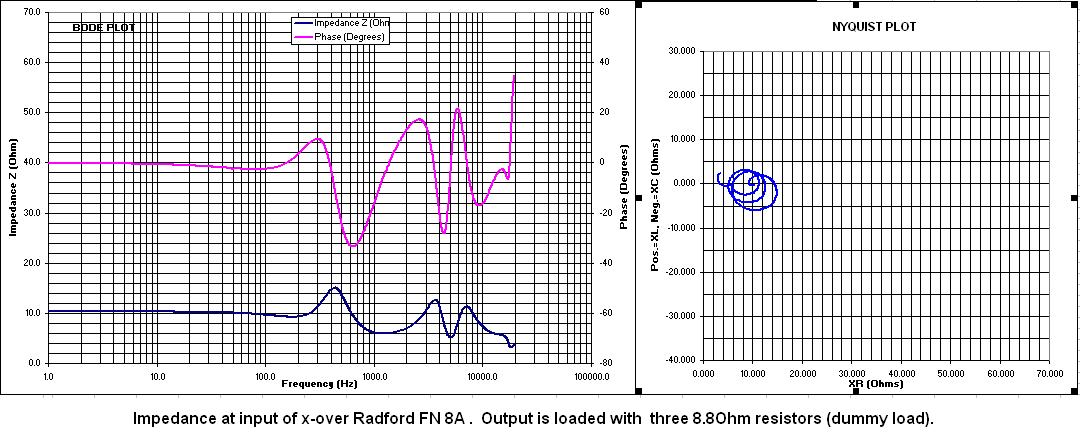

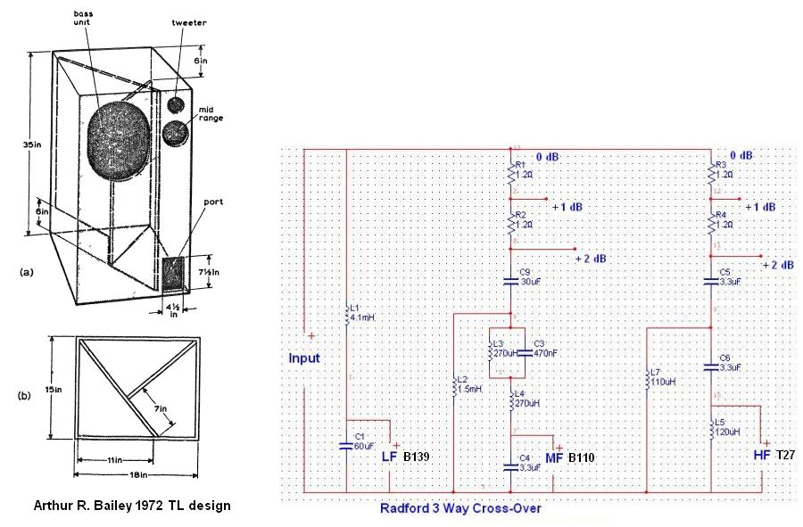

A British “another non-resistive load” example
George

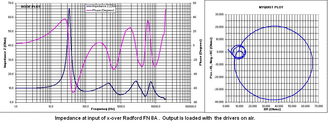

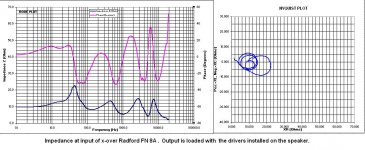

about 5uF.
We need very stable amplifiers for this speaker. High feedback factor is a bad thing here.
Above 1KHz the impedance looks a lot like the equivalent circuit shown below.
The interesting question is: Why is that inductance there? It's not because Peter Walker couldn't design a decent transformer. It's there to give a much-needed boost at the top end of the frequency response to compensate for the falling response of the ESL panel itself. The third pic below shows the response of this (admittedly oversimplified) circuit.

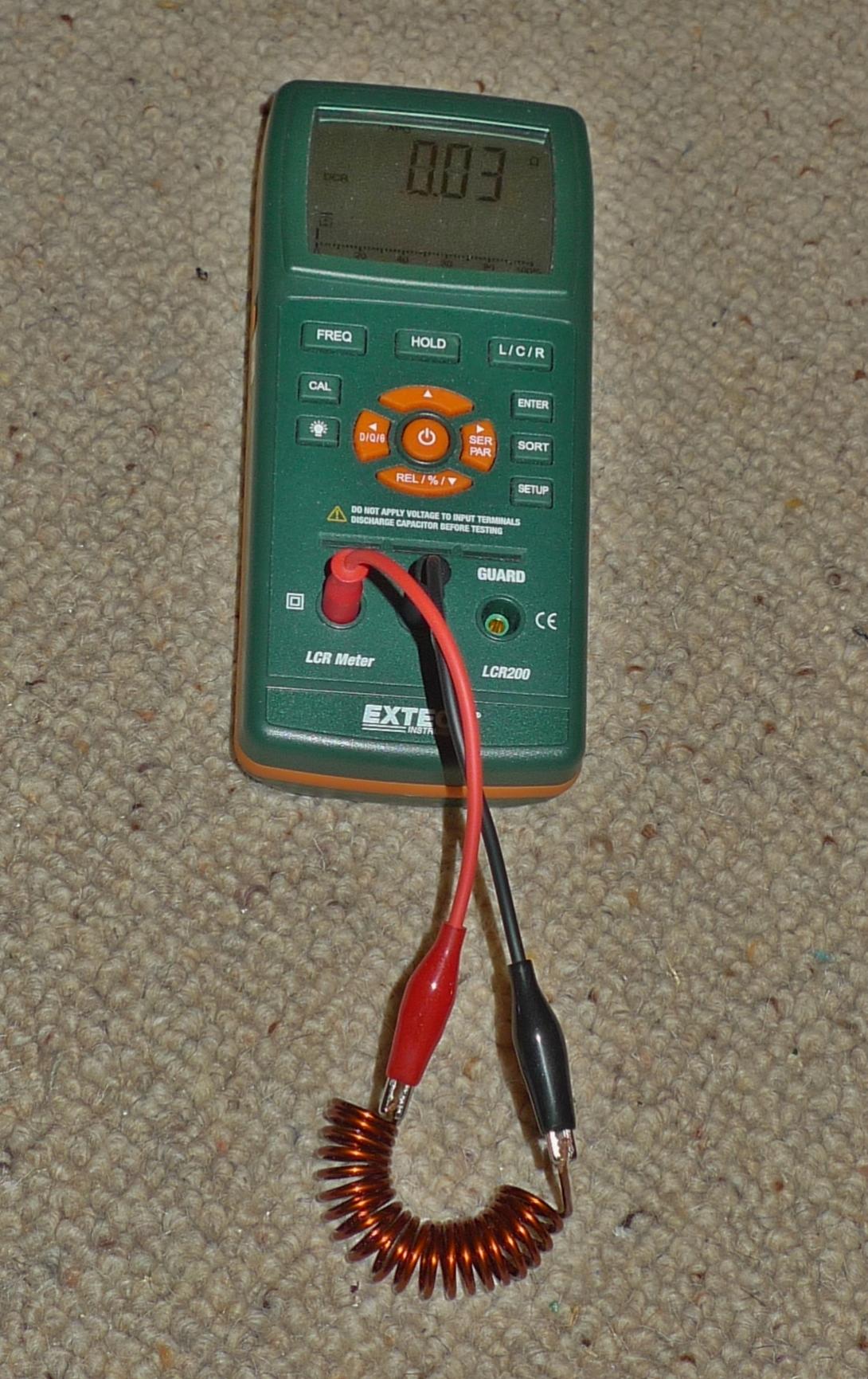

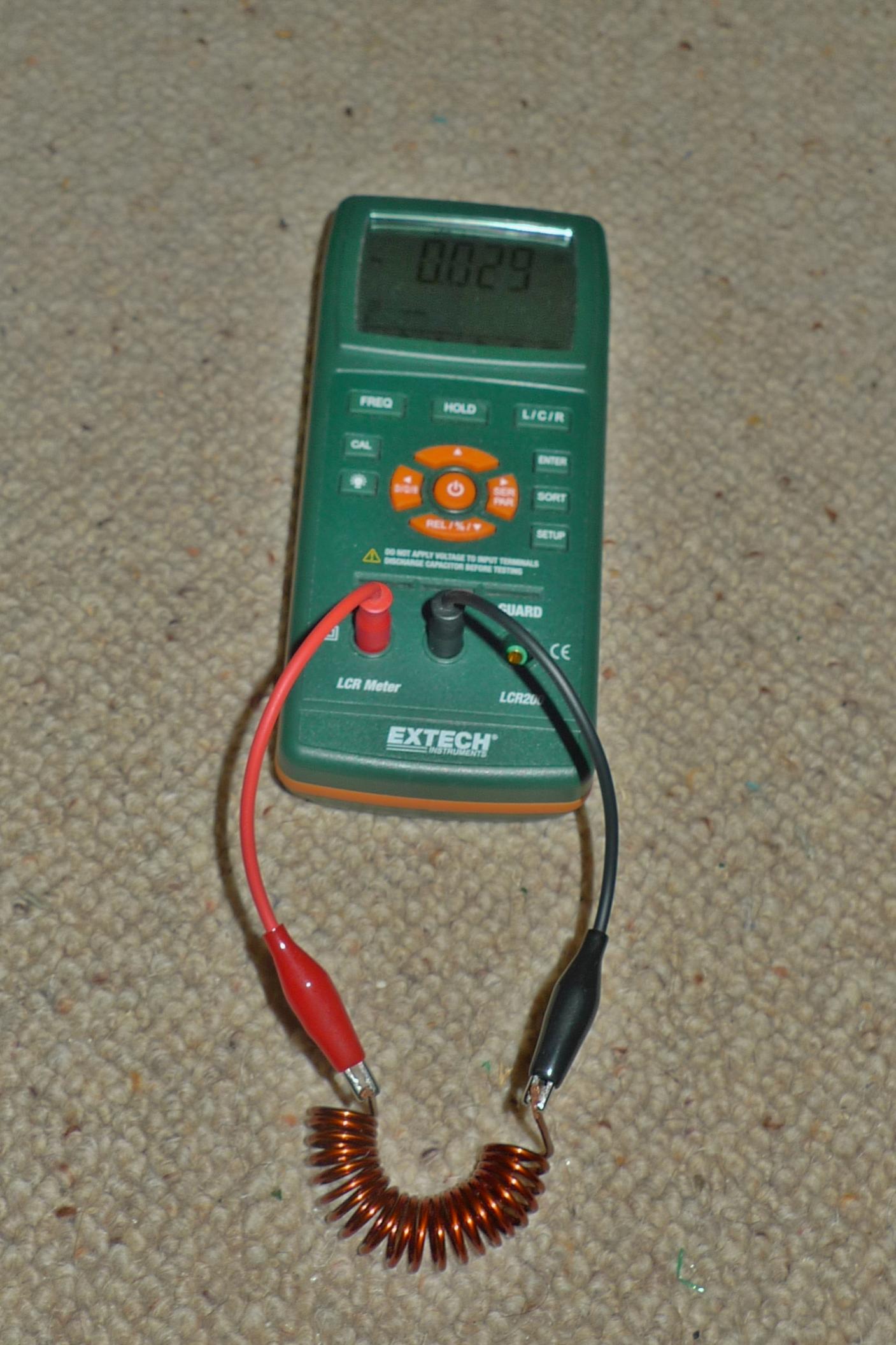

I am very conscious of o/p chokes emitting & picking up EMFs so I went over to toroidals a few months ago. Even so, I like to give the chokes room to work in.
Not sure why air cored chokes have about 10% lower values at 100khz compared with 10khz. 100khz is my top limit.
I normally measure at 10khz
I am very conscious of o/p chokes emitting & picking EMFs so I went over to toroidals a few months ago. Even so, I like to give the chokes room to work in.
Several things conspire to do this.
1. Proximity effect within the conductors cause the current within the wires to move to one side. This raises the series resistance because less of the copper is involved in current transport. It also changes the geometry of the coil, reducing the effective size of the coil.
2. External conductive surfaces will create eddy currents as a reaction to time varying magnetic flux trying to go through..lenz effect. As it restricts the volume of space the flux can occupy, it reduces the inductance.
3. If your meter can't handle the Rs rise, it will report incorrect inductance. When I frequency sweep inductance measurements, I look for too high a rise in resistance, as that tells me I'm leaving the accuracy zone of the meter.
I had some roughly 2 uH coils I scanned both on and off a two layer pcb groundplane board to show all this, I thought it was within this thread, but am not sure. I'll try to find it and post it later.

Bit Different but same anomalies.
1khz Ls 1.2uH Rs 0.006 ohms
10khz Ls 1.16uH Rs 0.009 ohms
100khz Ls 1.067uH Rs 0.029 ohms
DCR = 0.03
Oh, I just realized you are questioning the DCR...
You can't worry about the difference between R at freq and dc too much, as the meter will have less accuracy of R while in the L testing mode.
I didn't even think twice about the numbers, to be honest.
What happens if you short the inductor leads using a copper wire in that exact setup? That is meant to measure the test lead inductance.
