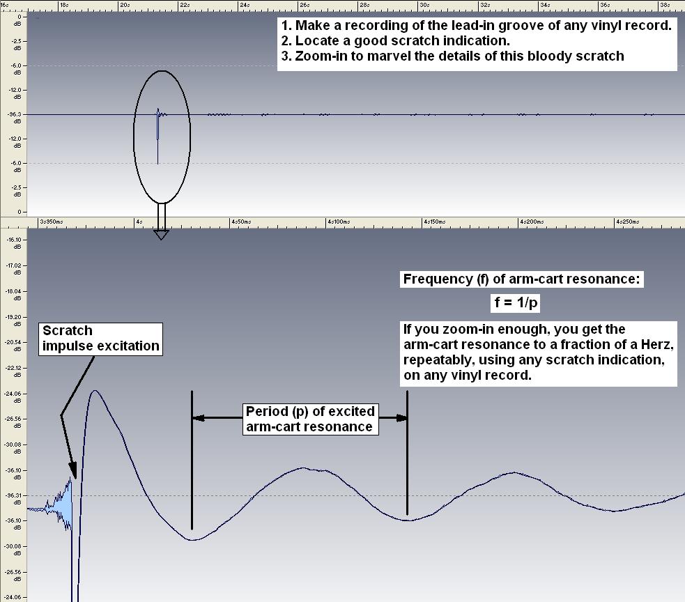

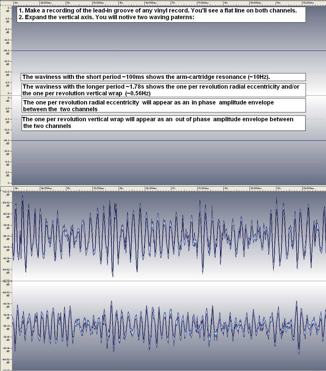

So run a test LP on your TT and send it to George or me and see if it is measurably better. The .56 Hz modulations are very hard to reduce. What's the magic number where euphonic turns to annoying?
The good news is that a test record is not needed. Not even an FFT analysis.
We can observe the effects, estimate the relevant amplitudes and extract the frequencies, only by recording a lead-in groove from any vinyl record we have. See attachments
It is part and parcel an integral part of the experience. You forget maybe, I have lots of LP's that I totally enjoy the way they are and plenty of 44.1/16 CD's too. I'm not the one complaining.
Some more observations on these (the bad news) I hope to type later.
George
