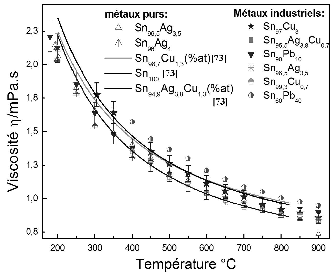

Using the materials as specified, i.e., comparing apples to apples, 60/40 will give a thicker coating because of a higher melt viscosity. Yes, changing other parameters will also change the thickness, but there is a significant difference at a fixed temperature between the two alloys.
Data?
I found some...
Here's the cover, I don't know how to give proper attribution, wrong language..maybe someone can help.
Physical properties of lead free solders in liquid and solid state
von der Fakultät für Naturwissenschaften der Technischen Universität Chemnitz
genehmigte Dissertation zur Erlangung des akademischen Grades
doctor rerum naturalium
(Dr. rer. nat.)
vorgelegt von Frau Souad Mhiaoui, M. Sc.
geboren am 16.08.1978 in Oujda/Marokko
Gutachter:
Prof. Dr. Jean-George Gasser
Prof. Dr. Bernard Legendre
Prof. Dr. Jens-Boie Suck
Diff doesn't look like it would vary much. Wish they compared 60/40 and eutectic..
Pic from page 140
I love the fact that typical solder pots run at 250 C, data on 60/40 only goes down to 400 C..sigh
jn
