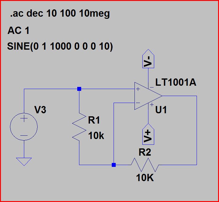

Next question then... if this is an idea worth pursuing for using opamps and extracting the best subective performance, what sort of values might you put on R1 and R2 as a ballpark starting value ?
As I posted before, it is a completely stupid idea to place a resistor between inverting and non-inverting inputs, exactly because you throw away feedback=error correction. The major effect is that distortion will increase!
Manufacturers recommend this setup to increase distortion in order to push distortion above the measuring limits of commercially available gear.
Only wacko audiophiles would consider this an advantage. If you want distortion in the first place, I suggest you start out with the worst possible opamp you can find.
