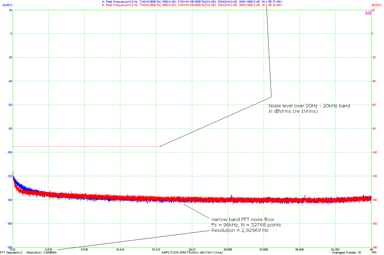

Now I'm really, really amused. Scott's choice, the AD8066, has almost 10 times the noise level of the OPA836 ...
Horses for courses, perhaps ...
Frank
???? 7nV vs. 4.6nV and no current noise, good for volumne controls. As I said at gain of 1 the noise is pretty much a don't care anyway think about the noise of the source. Say a really good .4nV preamp with 40dB of gain, that's 40nV at the output.
OPA836 has very high current noise in comparison to the FET input AD8066. In fact, OPA836 looks to have higher current noise than AD797 and LME49990, but without the super low voltage noise to go along with it. Which to choose depends on whether you are driving it with a low or high source resistance.
Still, I don't see why you would want to use it over any of the standard bipolar input candidates unless it's a portable application.
Below 1k the AD8066 noise takes off like a rocket, hitting 10 x the level at 10Hz ...
I am not fussed about noise levels, a little bit of hiss is not a problem for me ... but high frequency distortion really bugs me, that's a big turn off.
So what I like about the OPA836 is that its behaviour is still totally under control at frequencies 10 times higher than the audio band, it's got a huge margin of behavioural stability at its disposal. If an opamp is working at the ragged edge to get the numbers looking good at 20kHz then it's far more likely that the slightest abberation in the implementation will have audible effects ... IMO ...
