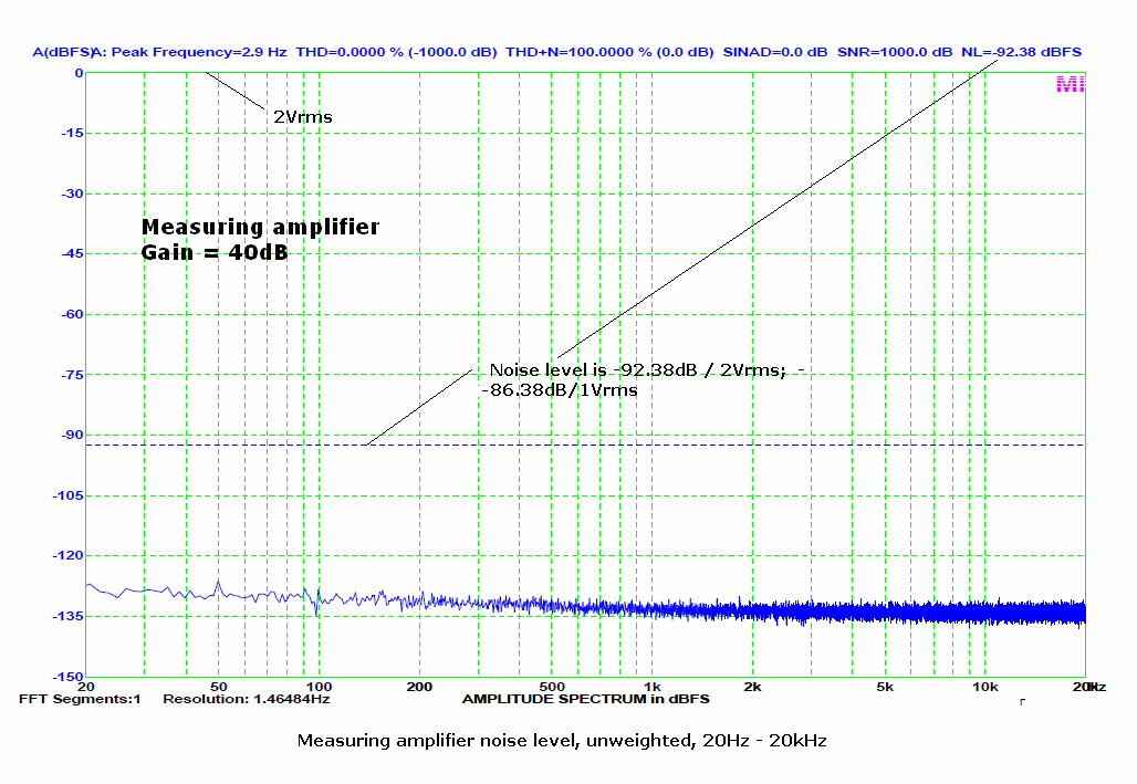

For the reasons you have just described, I built a measuring amplifier with gain 40dB to be able to measure noise level of preamplifiers and make FFT analysis (noise level which is normally below common audio measuring system threshold) and to be able to measure at low output level. My SW computes unweighted integral noise in 20Hz - 20kHz band, so no tricky "noise bottom" like -150dB etc, which depends on bin width (number of samples in FFT, sampling frequency and possibly averaging as well). Noise of the measuring amp is attached. So I amplify the preamp output by 40dB, measure noise and ten subtract -40dB to get preamp's noise. I also measure distortion, at about 10 - 20mVrms of preamp output voltage. I have not measured any increase of harmonic distortion at low signal output level, but found differeces in noise of preamplifiers and its spectra.
With this method, I can measure noise level down to -126dB/ref 1Vrms (20Hz - 20kHz, unweighted). The best preamp I measured had noise -115dB/1Vrms unweighted, 20Hz - 20kHz. The gain of that preamp was 14dB.
