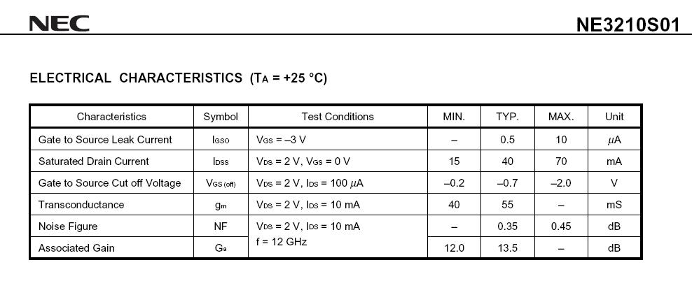

NEC N channel GASFET -> (Don't drool folks it probably has 1000nV/rt-Hz @ 1kHz)

I don't want to put him on the spot, I don't think he was fully thinking about your question. 1) I have seen no GASFET's that were any better than silicon ones for Idss spread. 2) GASFETs have little or no use at audio frequencies.

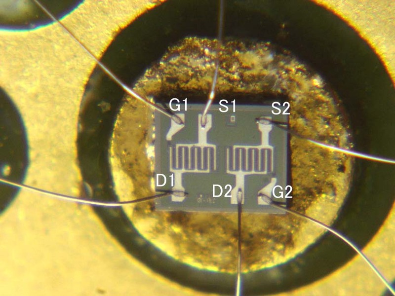

Speaking of geometry, anything that can be derived from this picture ?

Why does it look like S2 should be D2 and D2 should be S2? Or the other way around, S1 should be D1 and D1 should be S1.
Are they labeled correctly?

S2 and D2 should be swapped, gate should be away from drains and the drains sould be far apart (as is possible).
