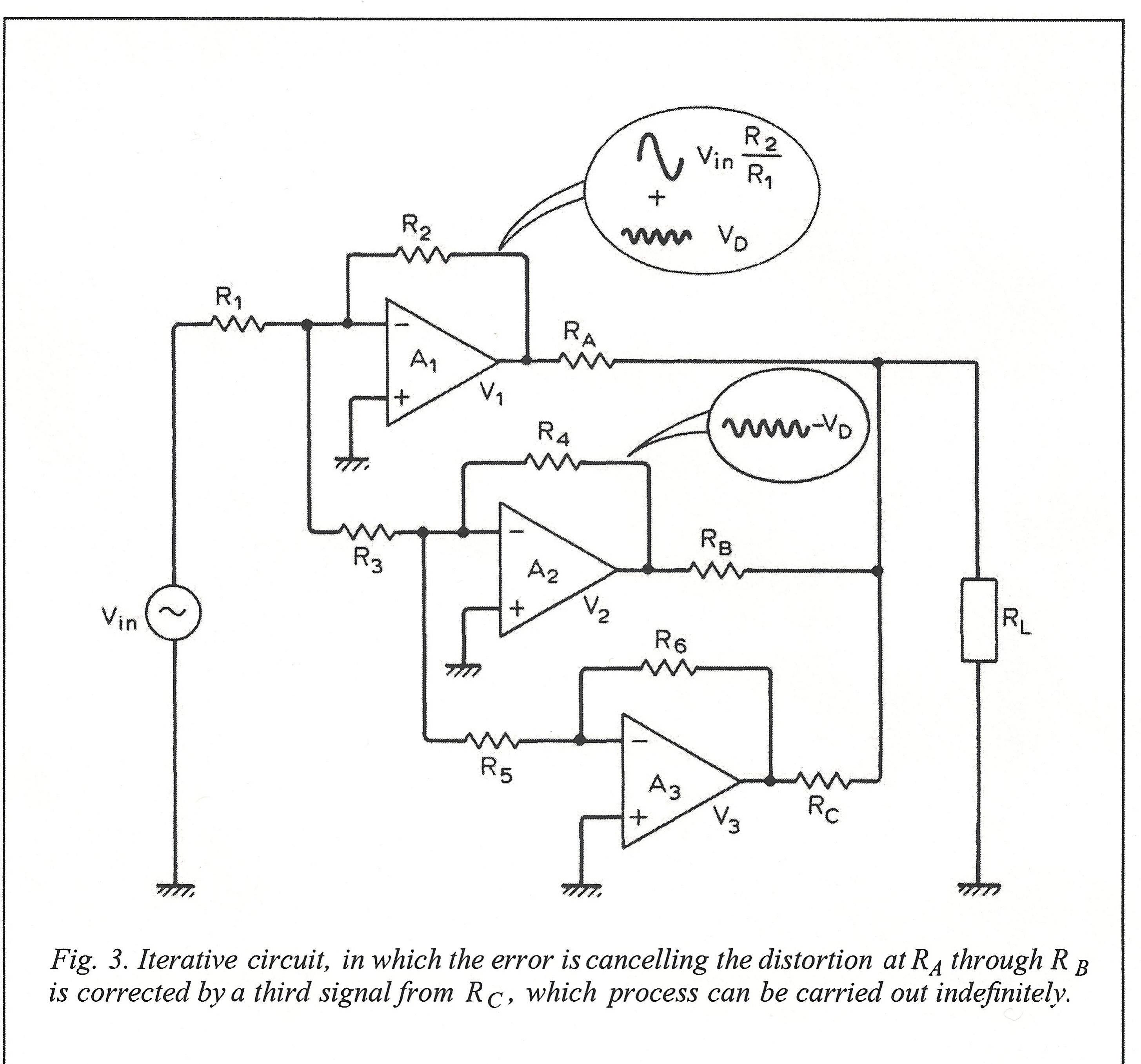

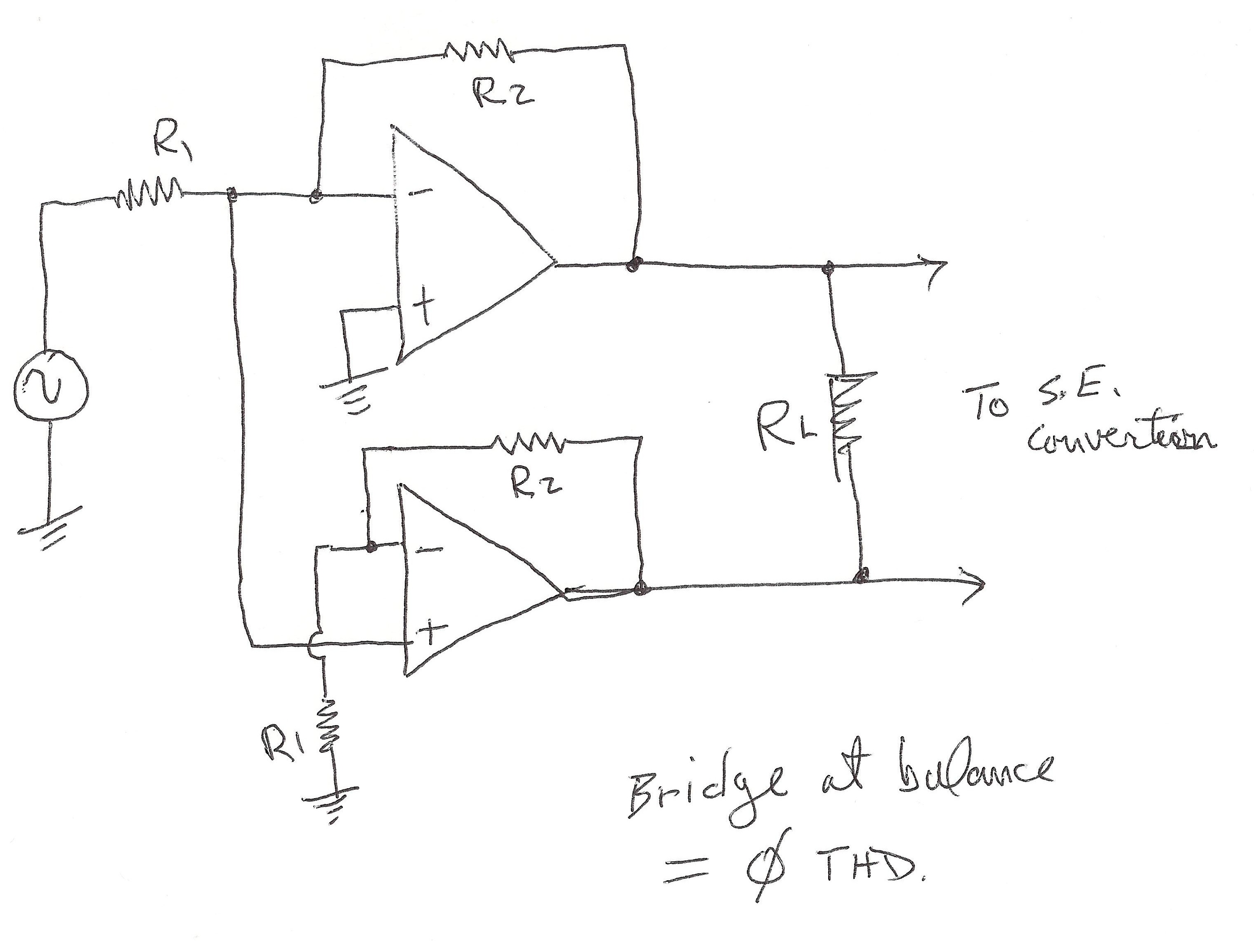

Bridge circuit +
Another amp for what ever -->
balance the bridge circuit and get zero thd.
Use error take-off and bypass the gnfb issue of lower fb at higher freqs.
-RNMarsh
