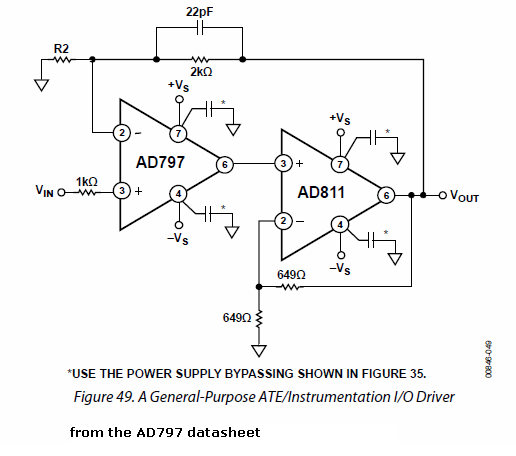

'BUFFERED OUTPUT' PMA, This is not how it is normally used. Please show me the buffer, if you will? Did you compare it with an AD825 with the SAME BUFFER?
No, I will not.
But output buffering, though different from mine, is shown in the AD797 datasheet, and was shown here few weeks ago. Datasheet image attached. Once again, my buffering scheme is different.
AD825 is not that transparent and does not have such good resolution - probably for the reason it is very noisy. But AD825 sounds "nice" (= equalizing).
