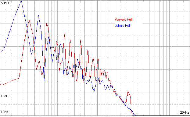

Helicopter Recording Spectrums
Not that it means anything ... different helicopters, different flight patterns etc but here are the spectrums of Wave's & John's helicopters analysed as requested.
23s just before the overload on Wave's
21s around the max. level on John's cos his is 48kHz fs
Vert. scale is 50dB. Horizontal scale 10Hz - 20kHz ie B&K 2307 bogroll
Hanning windowing (smoothing)
I've matched levels @ 1kHz but one could argue I should match between 100Hz & 500Hz as I expect both mikes to be sorta flat in that region and there's a lot of helicopter noise there.
Details of records: when I recorded that helicopter I put microphones about 1 meter (3 feet) from the wall, under the roof edge of my barn. I wanted to record the rain. That curve in the room was recorded on a distance about 5 meters from woofers, about 2.5 meters from the rear wall. Sub is under the left wall (opening in the floor) about 2.5 meters left. I did not test the mic then, I replaced the amp for the sub, and measured relative levels of the sub, woofers, and line arrays in the wall.
