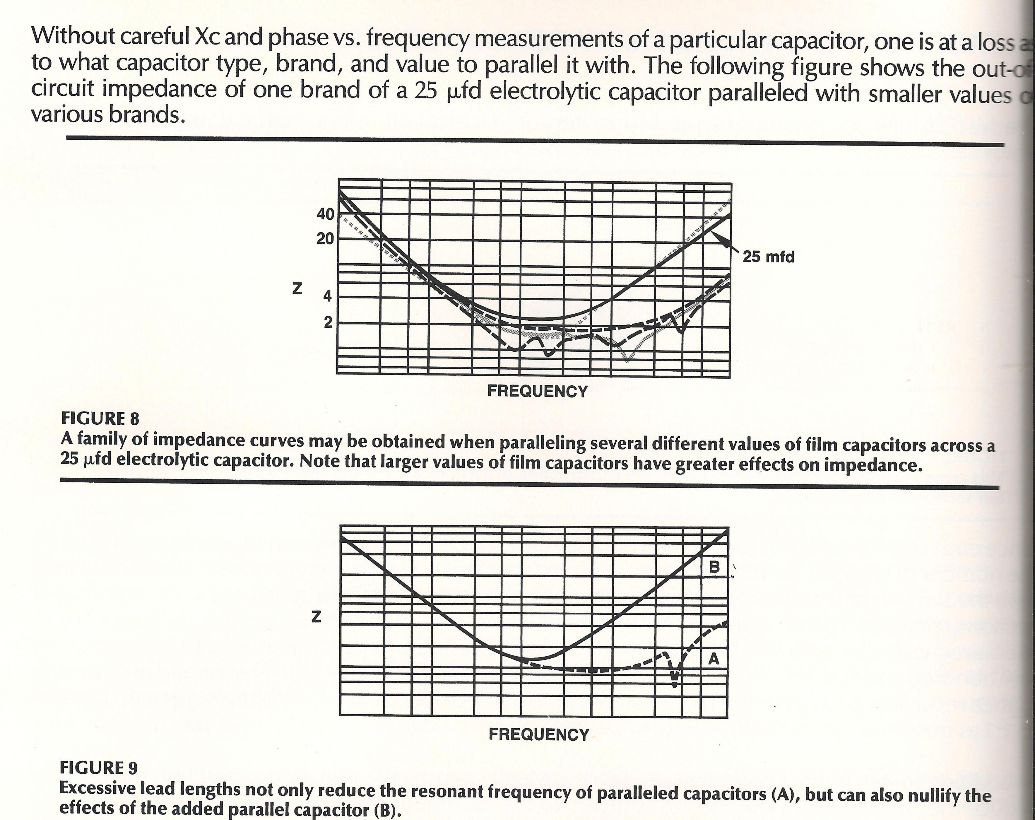

While we are waiting for JC to come back -- has anyone ever seen the 'real' Z formula for a Cap with its parasitics? Or ESR of a 'real' capacitor?
[Exerpt from white paper I wrote a million years ago.] -RNM
As I usually ask put some numbers on these and show the real magnitude of the audio band abberations. I would expect the parallel resistance and lead inductance to make little or no contribution at all.
BTW I disagree with the caption on 2a the measured C depends on the frequency of measurement, as you approach DC you measure all the C. The comment about Qa not contributing to the potential, I don't get at all what that's supposed to mean.

Numbers: it all depends on the application. Since this is only about cap parasitics, no app number were provided. In fact, it wasnt actually for audio only... caps in general plus some comparison info with my patented cap. You will have to put the numbers in for your own app. S/H, filter, HF, high current, high temp, etal. If you dont know the parasitics, it could make or break a design. For audio -- biggest issue is in speaker cross-overs which have to pass high currents. Particularly of interest would be the bipolar types often used there.
Yes, c can vary with freq.... depends on dielectric material. Varies with temp as well. Shown in cap mfr literature.
So even these more complete formulas are simplified somewhat.

phase of C's and L's -
Many people think that a broad low Z power supply is desireable - beyond ripple smoothing. The large value electrolytic caps have high inductance (unless special techniques are used $$). Bypassing with smaller value, lower Ls, film caps has been used for a long time to extend the bandwidth of the pwr supply filtering - beyond ripple filtering.
That can all be lost with just a few inches of added lead length -- wiring - whether pcb or wire from Pwr Supply to circuit. I still see circuits assembled with the ps bypass caps remote from the circuitry ... little benifit and waste of money. Shown is how just 12 inches of lead length added has nullified the effects and you are back to what would be the z of the single ripple filter cap. -RNM
Dick, this is the Blowtorch thread and I think the average level of sophistication here is above being reminded to not have 12" leads on high frequency bypass capacitors. Not to say this isn't all good stuff but I usually figure we are talking about low level coupling and RIAA use.
