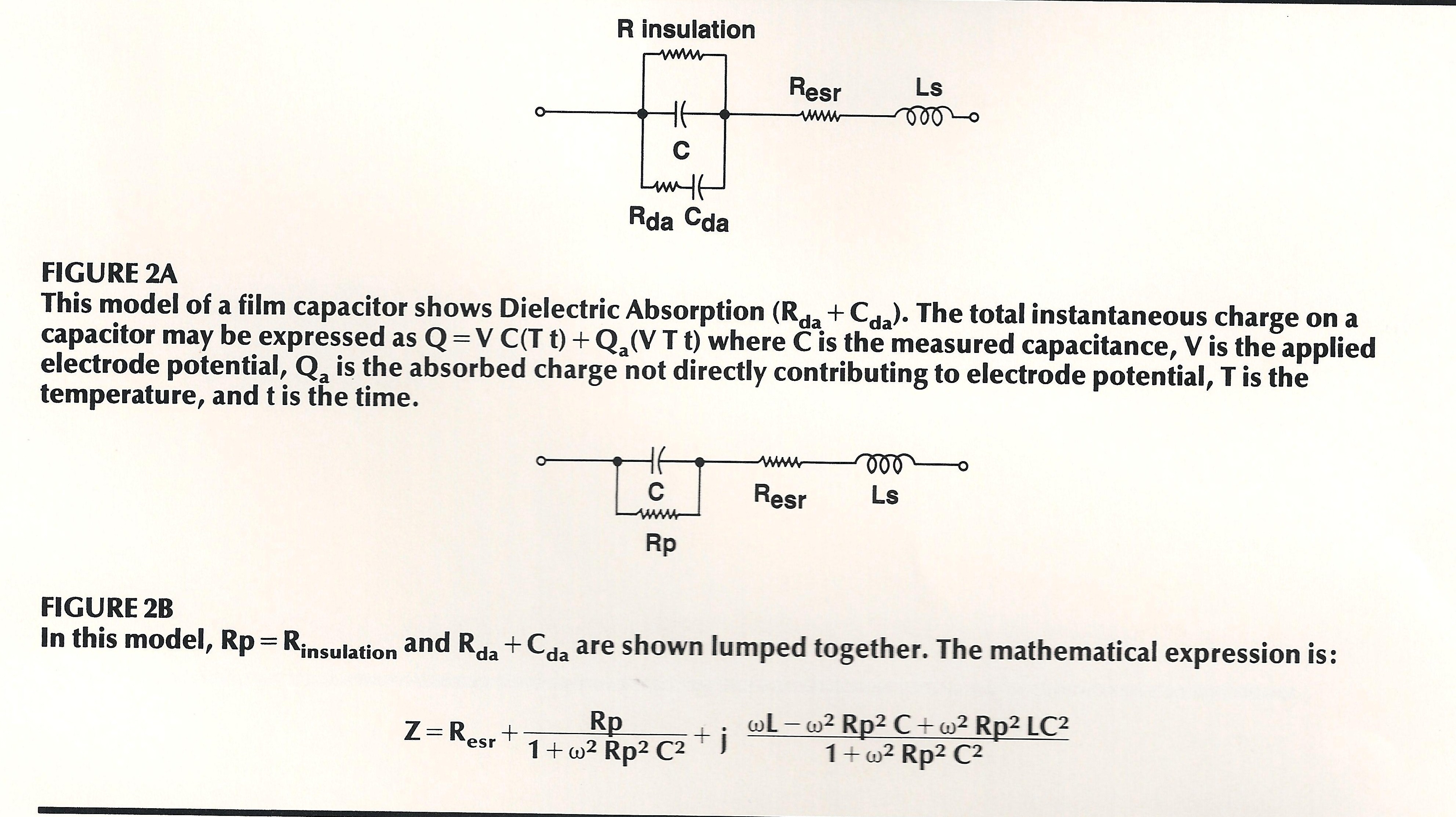

formula for real C's --
[/ATTACH][/ATTACH]

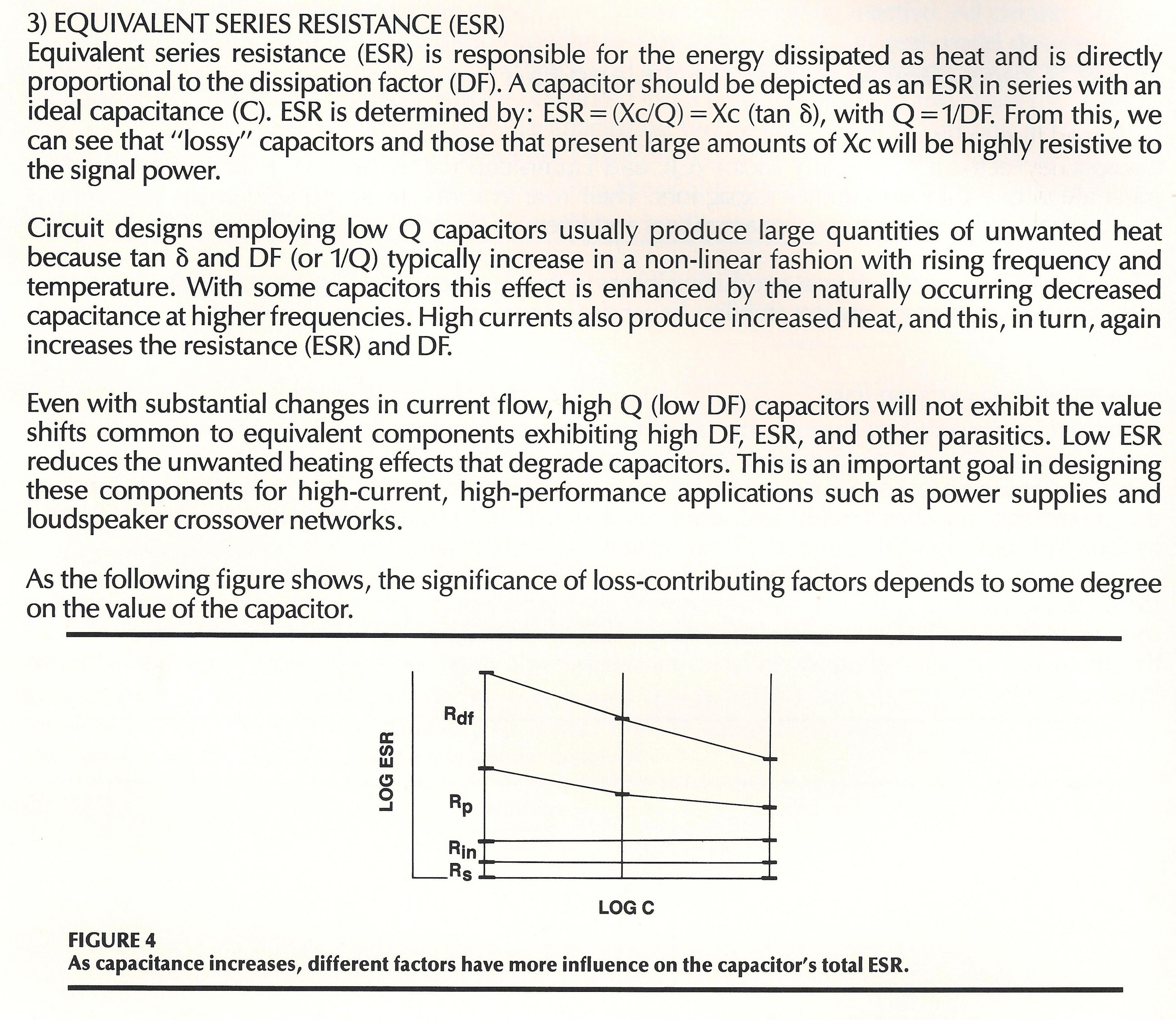

While we are waiting for JC to come back -- has anyone ever seen the 'real' Z formula for a Cap with its parasitics? Or ESR of a 'real' capacitor?
[Exerpt from white paper I wrote a million years ago.] -RNM
