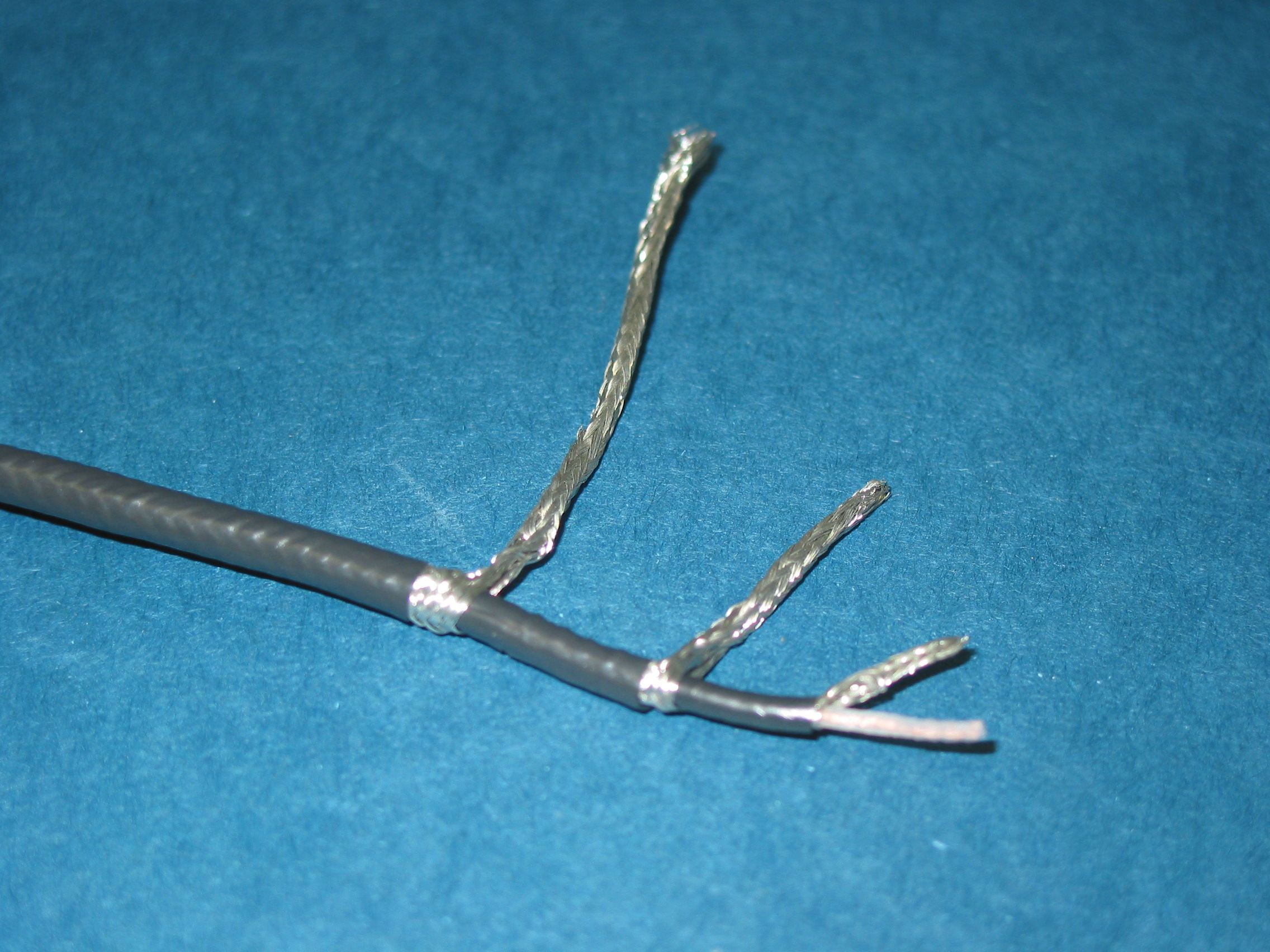

What did the design of the 10nH/ft one look like - you've eliminated some of the internal inductance of a cylindrical conductor at that extremity?
Me personally, I used a braid over braid coax. It is also possible to do so with ribbons, as the width of the ribbon increases the path reluctance. (my avatar is the field profile of a braid over braid coax.). But the conductors must be against each other to reduce external inductance and increase capacitance.
Within a pure cylinder like a solid wire, the internal magnetic field (DC) linearly increases to the wire surface. If you remove internal material from the conduction, you lose some storage so the internal inductance goes down. This is exactly what happens with skin effect. A cylindrical shell has no internal magnetic field.
I use a simple rule of thumb for a shell or braid for internal inductance..divide 15 nH by the aspect ratio of the braid...thickness divided by circumference, or even simpler, the number of wires in the braid.

ps. It looked like this. Here, I made a triple braid, but was counting on the two outer for the speaker connector, the inner braid is actually the shield for the core wire, I was using that coax for feedback from the speaker.
