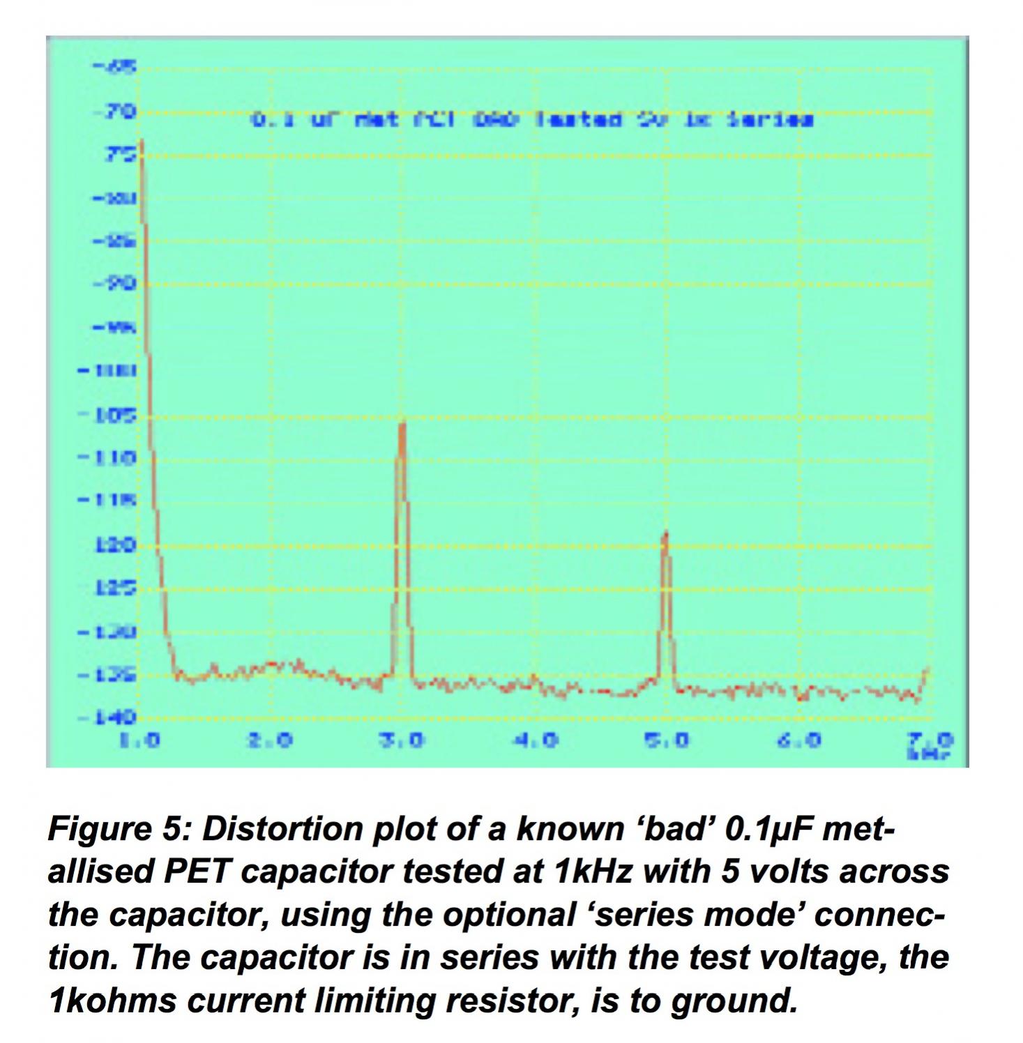

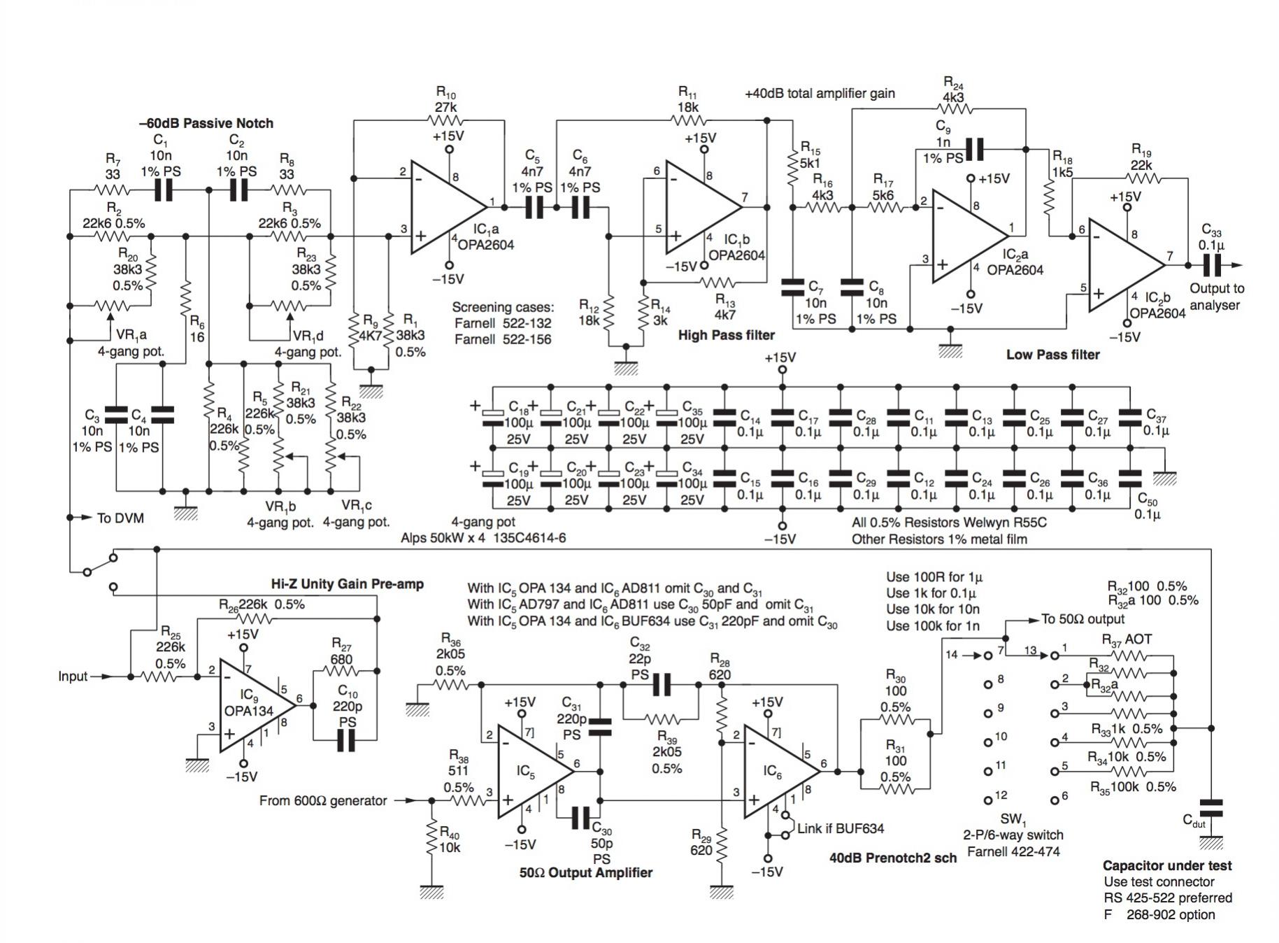

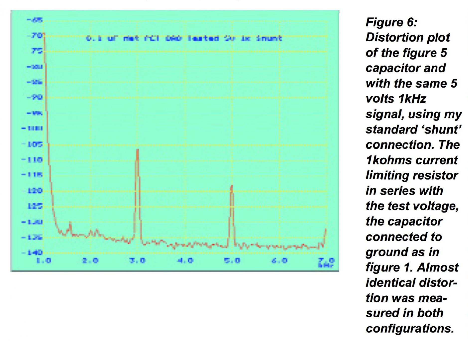

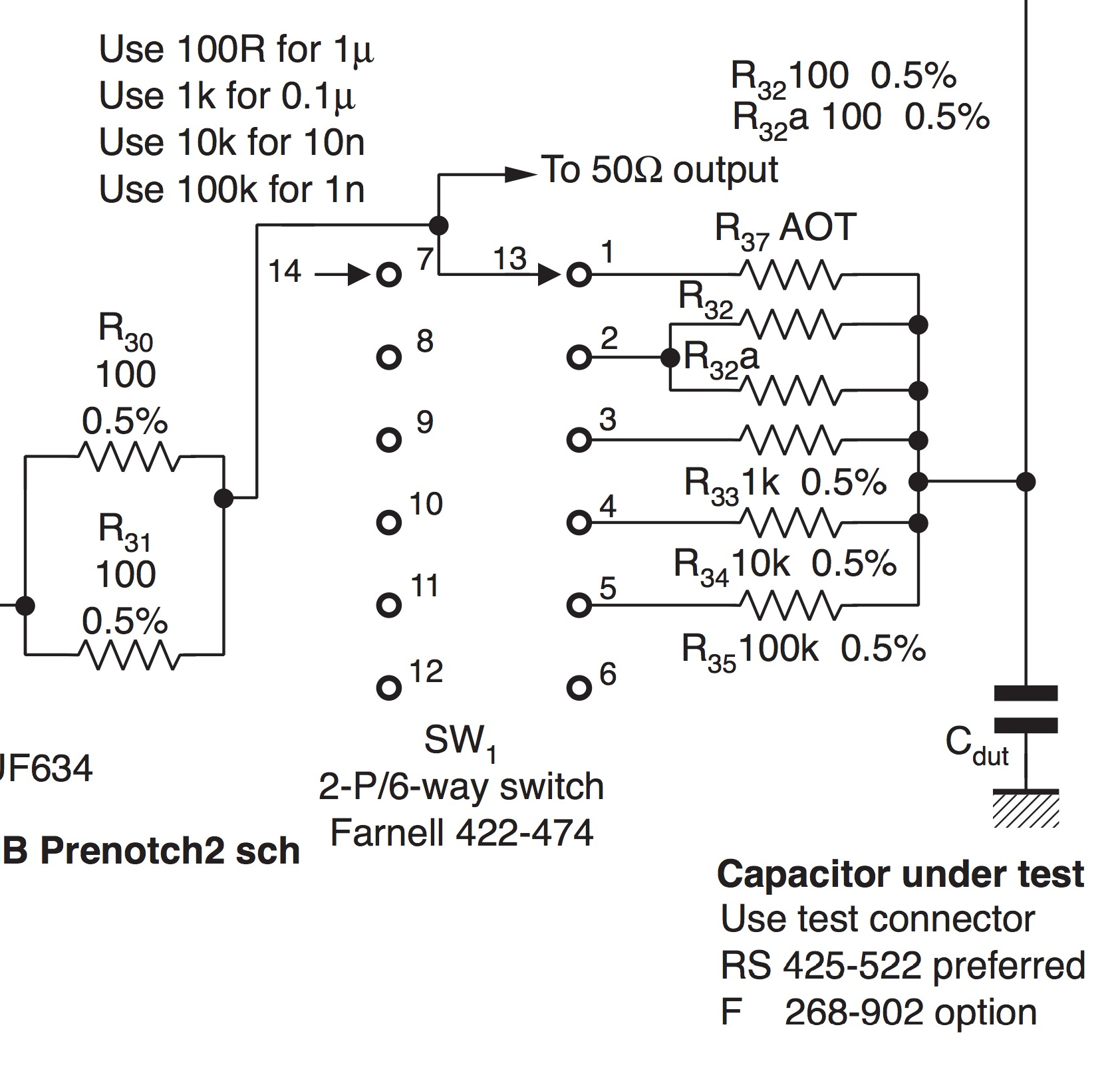

There was some question about the relative distortion of series vs. shunt caps. Bateman measured the difference between series and shunt cap distortion and found them almost identical. Below are relevant clippings from his article showing series/shunt test results, the test-setup, and a closeup of the DUT corner of his testing device.
Yes, for low order distortions they are bound to be almost the same. At higher orders some difference will be seen, as the ratio between capacitive reactance and feed resistor changes. To put it another way: feeding a current into a cap and measuring the voltage vs. applying a voltage and measuring the current, will give different results for higher order distortions. This is the same algebra as re-entrant distortion from feedback loops.
Joined 2004
If the distortion mechanism is the same (as it must be) then any difference is related to the external impedances not the cap. I'm not sure what is to be learned from this. The relationship between the phase of the distortion and the fundamental may give a clue as to what part of the cap is generating the distortion. On the RE CLT-1 they give very specific directions on how to scale the measured distortion vs the devices reactance at the harmonic being measured but this makes sense once you understand what is happening.
Using a lower impedance source won't change the nonlinearity, but it will scale the harmonics.
Yes, the cap will behave in exactly the same way to whatever signal it is given. However, the distortion in a current produced by an exact sinewave voltage will be different for higher orders than the distortion in a voltage produced by an exact sinewave current. This is because, for example, the inverse of square (a simple polynomial) is square root (an infinite series).
