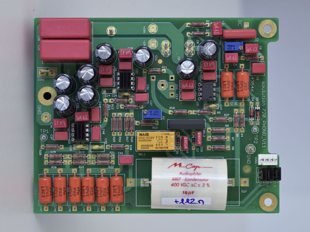

Doesn't look like a relay to me, more like one of those flat opamps like JRC makes.
The reference designator is consistent with the other relay.
I finally recognized the three inductors next to the connector, lower right corner. I thought they were power supply isolation. That is really close to the big cap which is the output connection.
I can see maybe 1 MHz max with this layout. But what constitutes correct at 1 MHz for a phono transducer?
It would not matter at a $5K price point. It could be made in the USA for about $5000 retail. There just is NOT enough in the circuitry to justify the $25,000 cost.
We, for example, are bringing out a $19,000 phono stage that has 10 times the active parts, better caps, and includes a power supply. That is still very expensive, but at least there is a lot more inside the fancy chassis.
The Soul--- design looks like a Levinson LMP-2, well engineered with IC's and cost effective parts, primarily.

A Reed relay in a SIL/SIP package is at least 2.5 times thicker than a JRC SIP8, the SIL also has a roof-shape top, hard to miss on a picture.

"And LOOK at what you get with a JC-1, the quality of the components, (no IC's in the audio path) . . . "
The quality of the components on that PCB look pretty ok to me. WRT IC's, if you ever spent some time inside a modern semiconductor fab John you'd understand that your statement is pretty ill informed.
It seems to me the Solution folk are the first to cotton on to the fact that you can charge >$25k for an op-amp based phono amp, while you - a discrete FET proponent - can do no better than to say your effort is worth every penny of its $2.3k charging price.
Well, I tell you what, Bonsai. It just so happens that the JC-3 phono stage is also made with IC's. It would be more expensive, much more expensive, if it was made of discrete jfets.
Of course, you can put together a throw-away piece of junk that will serve as a phono stage for less than $100. I suggest that you do that, but you will never win any listening comparisons with it. I like to win listening comparisons.
IC or discrete, a lot of the cost is in the execution & peripherals.
The 750 uses bus bars for power distribution across the main board.
Power lines and signal to the phono boards go through vertical bars, and not wimpy ones either.
Signal enters in the center of the board, with signal ground next to it.
It looks as if a raised resistor is soldered from the top, between the lead of R11 and signal ground, but after the phono board is mounted and soldered to the vertical bars for +/-15V, power ground, signal in, signal ground.

(the 4-pin wire connector in the corner of the board is for Rel1 & Rel2)
http://www.diyaudio.com/forums/atta...ls-blowtorch-preamplifier-part-ii-soul750.jpg
